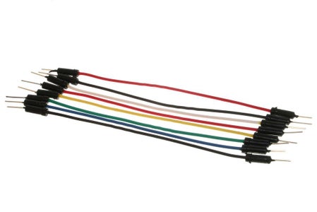

  2. Magnet Polarity Detection module
  3. Jumper wires

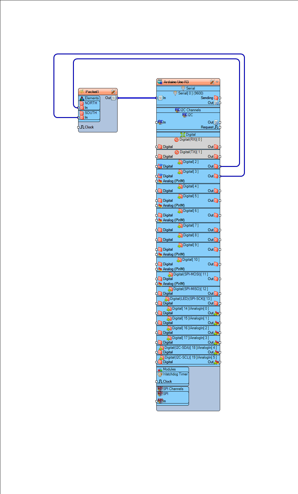

Step 3: Start Visuino, and Select the Arduino UNO Board Type
Start Visuino as shown in the first picture Click on the "Tools" button on the Arduino component (Picture 1) in Visuino When the dialog appears, select "Arduino UNO" as shown on Picture 2

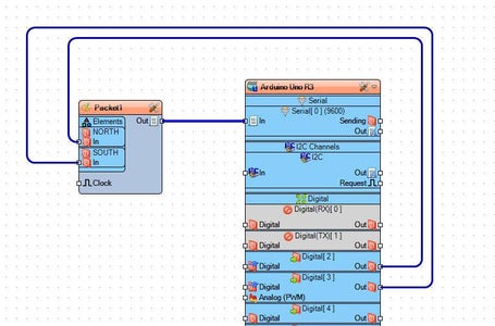

  1. Add "Packet" component

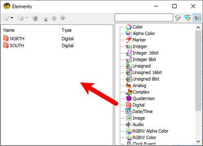

  2. Double click on the "Packet1" and in the Elements window drag "Digital" to the left side and in the properties window set "Name" to "North", drag another "Digital" to the left side and in the properties window set "Name" to "South"
  3. Close the Elements window
  1. Connect Arduino digital pin [2] to "Packet1" > "Elements" > "North" pin [In]
  2. Connect Arduino digital pin [3] to "Packet1" > "Elements" > "South" pin [In]

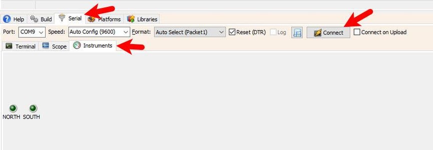

Step 6: Play
After you upload the project, click Serial tab and Instruments Tab, Make sure that you select correct Port and Click on the Connect button. Now you should be able to see the magnet pole detected by the sensor.
