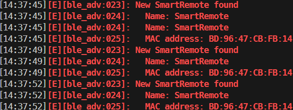

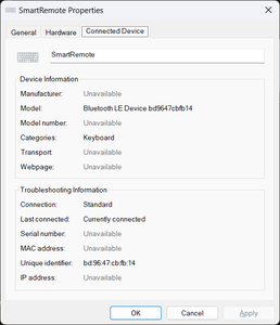

Step 6: Finding Remote MAC Address
First of all you need to find your Remote's MAC address. Make sure your Remote is not connected to any device. For that remove it from all previously paired devices. In this state Remote should blink several times when you press any key. If led is not blinking but stays on for several second and goes off that means that Remote is currently connected to some device.
To find Remote's MAC address you have 3 options:
  1. Flashing ESP32 module and checking console output:
  2. Flash ESP32 with default config provided below.
  3. Press any key on the Remote so it starts to blink and advertise packets.
  4. Check logs and note Remote's MAC address:
[14:37:45][E][ble_adv:023]: New SmartRemote found
[14:37:45][E][ble_adv:024]: Name: SmartRemote
[14:37:45][E][ble_adv:025]: MAC address: BD:96:47:CB:FB:14

  5. Using Windows PC with Bluetooth module:
  6. Press any key on the Remote so it starts to blink and advertise packets.
  7. Find and pair your SmartRemote device with PC.
  8. Run following code in command line:
shell:::{A8A91A66-3A7D-4424-8D24-04E180695C7A}
  1. Double click SmartRemote device.
  2. Go to Connected Device tab.
  3. Note Remote's MAC address in Unique identifier line.
