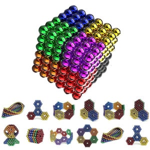

  1. Magnet balls 5mm - https://amzn.to/44wig94

I think using 5mm magnetic balls are the best balance of magnet strength.. you can use 3mm magnetic balls or 3mm neodym magnetic cube but it wont have enough strength to hold several magnet pieces without bottom supports..
Dont use 5mm magnet cubes as it will not be able to turn around inside the cube.. and you will lock the polarity of the cube.. making it wont stick to cubes that has the same polarity..
