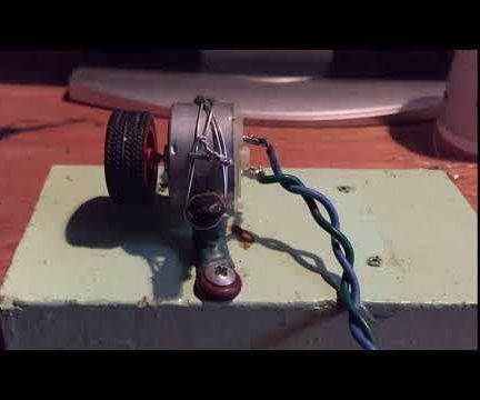

Step 3: Make the Fish
I used very little metal wire for my magnets. I touched my 1.5 V battery and it seemed to be getting hot and losing power quickly. You should try using more turns because the magnet equivalent resistance was very low.
Step 4: Testing
Initially I made the fish without the two flippers on both sides and it was capsizing. Then I added additional flippers.
