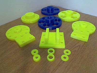

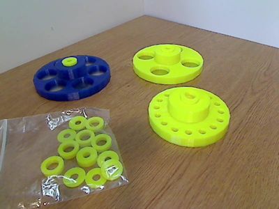

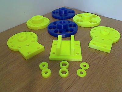

Step 1: 3D Printed Parts
Print 1 each of the following files:
Printed at 20% infill
No extra support is required. (already built into files that need support.)
  • Base_For_Bolt-Nut_Stand
  • Large_magnet_Ring_4_Mag_32mm_with_Bearings
  • Small_Magnet_Ring_16_Mag_with_Bearings
  • Stand_For_Bolts_No_Bearings
  • Stand_For_Nuts_No_Bearings
  • 608_Bearing_Replacement
  • For extra experimenting if wanted:
  • Large_Magnet_Ring_6_Mag._32mm_with_Bearings
  • this has 6 magnets making a 3 pole pair. (same rotation)
Remove all Support structure where it was used (not much used)

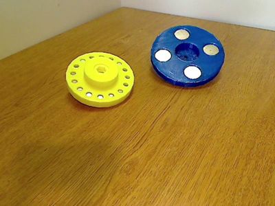

Step 2: Assembly
Clean / and remove the support material from printed parts.
Press and / or glue the magnets in to the Magnet rings.
Alternate "North" then "South "then "North" then "South"... etc.
Check polarity of magnets as you install them.

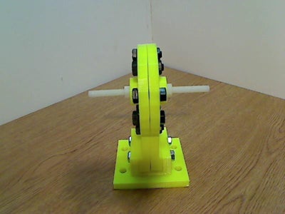

Bolt the Bolt Stand and Nut Stand together Flat side facing each other.
Using 16 M8-1.25 x 25mm Hex Bolts and M8-1.25 nuts.
install a M8-150 mm Aluminum shaft or tube through the stand. assembled bolt/nut stands.
Attach the base to assembled Stands and secure with 2 M8-60mm hex bolts.
With magnets and bolts in place & tightened , slide a magnet ring on one side,
check for clearance between Stand and Ring.
The Magnet Ring should rotate freely. If not, you may need to add another washer.
Install a 8mm collar on each side of aluminum shaft if using.

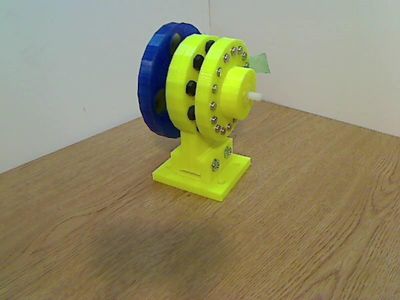

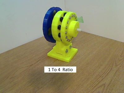

Step 3: Testing
This will demonstrate how the magnetic gear box works:
Step-Up gear box:: 1 turn of the small ring (Yellow) will turn the large ring (Blue) 4 times , Opposite direction
Step-Down gear box:: 4 turns of the large ring (Blue) will turn of the small ring (Yellow) 1 time, Opposite direction
Removing the Large_magnet_Ring_4_Mag and install the Large_Magnet_Ring_6_Mag.
Now you have 8 pole pairs on input ring and 3 pole pairs on output = 11 pole pairs.
Step-Up gear box:: 1 turn of the small ring (Yellow) will turn the large ring (Blue) 4 times , Same direction
Step-Down gear box:: 4 turns of the large ring (Blue) will turn of the small ring (Yellow) 1 time, Same direction
