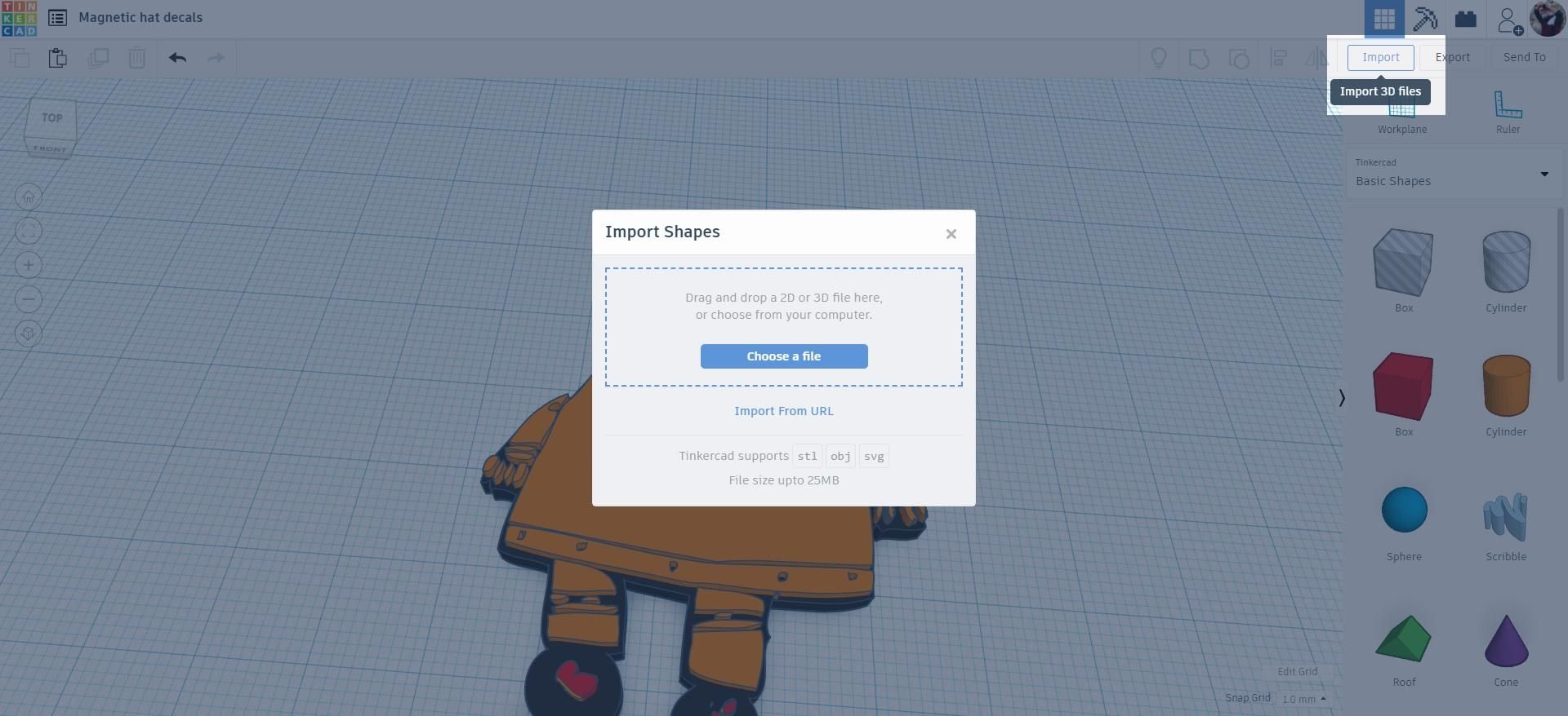

When you've downloaded your SVG files it's time to upload them. Look for the import button on the top right of the toolbar. Drag the SVG into the pop-up, or browse your computer to find it and then upload.

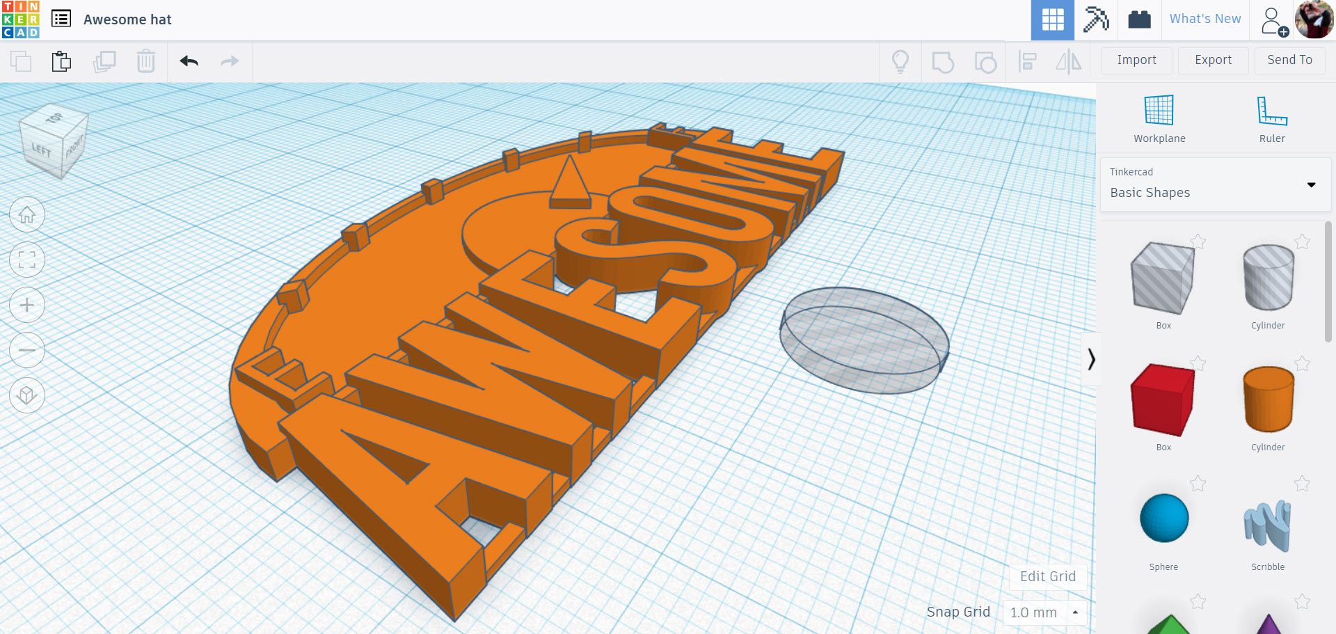

With the magnet shape on the workplane, it can now be placed anywhere on the hat decal. Magnet placement is something you should be thinking about as you design your decal.
It's usually a good idea to center the magnet on the decal, but it's critical to make sure the magnet placement is somewhere that has enough material to completely hide the magnet. So, if the magnet is 1.75mm high and needs 1.5mm of depth, the model will need to be at least 1.75-2mm deep wherever the magnet is placed.
In the example shown here the magnet can be moved around to the thicker part of the model to completely conceal the magnet.
When the magnet is located in a suitable place, select both the decal and the magnet hole and combine the two to make one shape with a cavity in your decal for the magnet.
