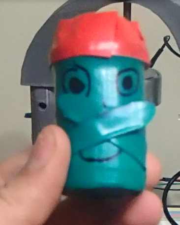

Step 14: The Levitating Objects
The Levitating Objects are 35mm film canisters, with magnets. One magnet is placed on the lid, and 2 underneath the lid. They are filled with some oil to dampen vibrations. After, I decorated them with electrical tape. They weighted in at about 65-75 grams. If I were to remake them, I would have them all with identical weights, as that would work better. I did try large 1 inch (diameter) neodymium magnets, but they were so powerful they just flew up and stuck to the metal casing on the electromagnet because they are stronger than the electromagnet. You must ensure that all the magnets are put on correctly, and that the same pole on the magnets faces up. You can do this by pushing the top of each object together, and every object should repel every other object.
