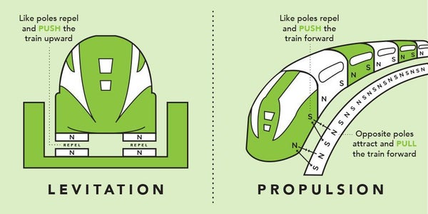

Trains powered by electricity make up the backbone of many transportation systems around the world. There are many different designs and methods for converting electrical power to propulsion, but one relatively popular method is a linear motor. A linear motor uses a series of dynamically alternating electromagnets along a track to interact with permanent magnets fixed to a train, pushing it forward. In this project, we will create a small model of a linear motor, utilizing dynamic sensors to detect the train’s location and electromagnets to push the train along. We will also create a simple magnetic levitation system in order to reduce friction and increase performance of our design (as well as look really cool!)
Thus, our magnetic train will be based on two ideas: levitation and propulsion.
