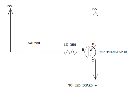

Step 6: Automatic Power Supply
I thought this was the best option, but my daughter just couldn't find a way to get her locker door to hit the switch when closed, so I eventually nixed the idea. I include it here because I still think it would be the best way to go, if you could get it to work.
Basically, you should build this circuit on your perfboard and place it in the middle of the wire that connects the positive end of the 9 volt battery clip to one of the foil "combs" on the main board (I stuck a magnet to the ends of these wires).
The switch should be stuck to the inside of the locker in such a way that when the door is closed, the switch is closed, and when the door is opened, the switch is opened. This circuit activates the lights when the switch is open, so you don't have to mess around with turning it on or off after it's been set up the first time.
Once the circuit was built and tested, I glued the battery clip to the bottom of it and then used some sugru to cover the electronics, as well as hold another magnet to the top of the perfboard (see below).
