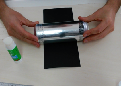

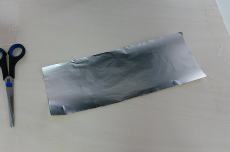

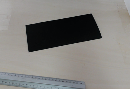

Cut a sheet of aluminum foil of dimensions 11x24 cm and roll it around a can, cut a piece of cardboard of the same size and roll it over the aluminum foil pasting to it.Once the glue dries, remove the cylinder from the can.

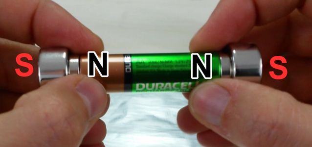

I used to make the rotor:
a high quality rechargeable battery
2 Neodymium magnets of 15x4mm with hole
2 Neodymium magnets 20x10 mm
The polarity of the magnets is very important. I try to outline the position.
S-N battery N-S (With this configuration wheel on one side)
N-S battery S-N (With this configuration wheel on the other side)
S-N battery S-N (Do Not work)
N-S battery N-S (Do Not work)
