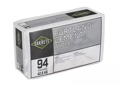

  • Type 1 or 2 Portland Cement - https://rb.gy/psgbj

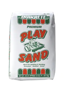

  • Play Sand - https://rb.gy/6et7u

Step 5: Concrete Pouring
Place your magnets in the mold where the discs will make contact. Then pour your Portland cement/ play sand mix into your mold.
WARNING: Magnets and metals are corrosive and must be encapsulated in reef-safe silicone.
