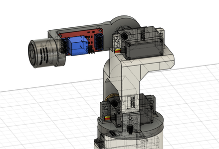

Hi, my name is Baymax, and I am a middle school student at Mounds Park Academy. I recently completed a challenging and exciting project—a fully functional robotic arm. This robotic arm features five movable axes, allowing it to perform a wide range of precise movements. Instead of a traditional claw, I designed it with a solenoid at the top, which provides a unique way to interact with objects.
This project took me approximately eight months to complete, involving multiple stages of design, testing, and refinement. Throughout the development process, I faced various challenges, especially in programming and ensuring smooth movement across all axes. And also the program has gone through 3 major iterations.
For the design and modeling, I used Autodesk Fusion, a powerful 3D modeling software that helped me bring my vision to life. And For programming, I used Mind+.

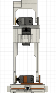

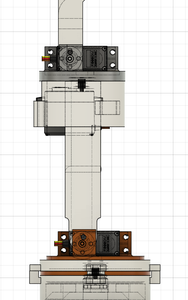

Step 1: Designing Robotic Arms
Designing Robotic Arms (My robot arm design tools is autodesk fusion). My robot are is gone through three iterations.
