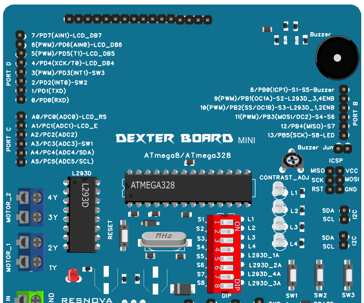

Step 1: Connect the Pins As in the Diagram
Here we use i2c protocol to obtain the value from the sensor. if you want to learn more about i2c go to Learn I2C.
Connect
Dexter lis3mdl
Vin-+5V
GND-GND
SDA-SDA on Dexter
SCL-SCLon Dexter
