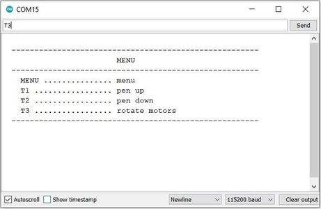

Optional motor software
Install the following software on a separate Arduino if you wish to rotate the motor using software:
- Run another instance of your Arduino software
- Select the COM port number for this second Arduino
- Download “bipolar_motor_test.ino” and copy the contents into a new Arduino Sketch ... use a text editor such as Notepad++ ... not a word processor.
- Save the sketch as "bipolar_motor_test" (without the quotes)
- Compile and upload the sketch to your second Arduino.
- Open your “Serial Monitor”
- Set the Baud speed to 115200
- Enter T3 in the Serial Monitor (photo 2)
- Use the Q and W keys to rotate the motor clockwise and counter-clockwise (photo 3)
