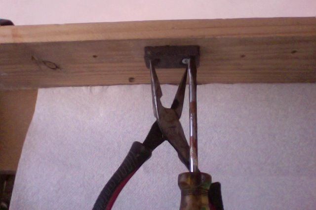

Step 9: Secure the Magnet and Bracket to the Underside of a Shelf or Cabinet
The last step is to secure your magnetic mounting bracket to the bottom of a shelf or cabinet. To do this, hold the bracket up to the surface and use your pencil to mark the mounting holes. Then use a drill to make guide holes in each location. Lastly use a pair of wood screws to secure the bracket in place.
Step 10: Use the Magnetic Bracket to Hang Small Hand Tools
You should now be able to hang small hand tools from your magnetic bracket. You can hang anything that is made of steel and is light enough for your magnet to hold. I prefer to use it for small screw drivers.
