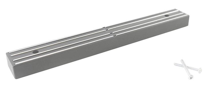

Step 2: Purchase a Magnetic Tool Holder
I used the Master Magnetics 07578 12" magnetic tool bar that has 2 screw holes. I bought two because I planned to hang heavy tools.

This step is pretty straight-forward. Just mark the holes on the mounting plate (or directly on the Gladiator bracket) so they align with the holes on the magnetic tool bars. Figure out what size machine screws you will use ahead of time to make sure the holes are the right size for the hardware you have chosen. I used what I had lying around since the screws that come with these tool bars are wood screws.
I used #8-32 1" long screws to attach the magnetic tool bar to the mounting plate. These holes drill 5/32".
