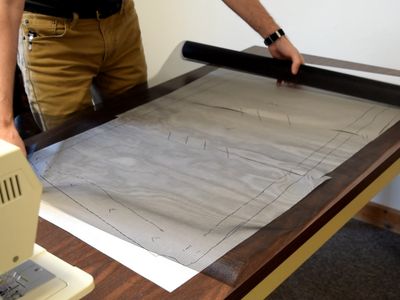

First we made a paper template of the window to help with the sewing pattern.
Step 3: Cut and Sew
Using the template, we cut the screen and cotton materials to fit.
We cut the cotton fabric in 4" wide strips, so that it folds over about 2" on each edge. We then sewed the two materials together. Sewn with two lines of stitching made for a nice pocket for the magnets to sit in.
