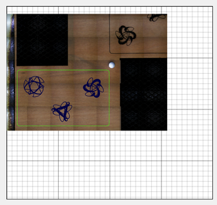

The first layer to be designed was the front cover, to be cut (#43F20D) and etched on thin wood (1.5mm laser ply) to allow the magnets to work through it. I chose to highlight where the magnets are with etching, in this case with spiral designs (#000044). I wanted it to be obvious where the key fob should be put by marking with imagery.

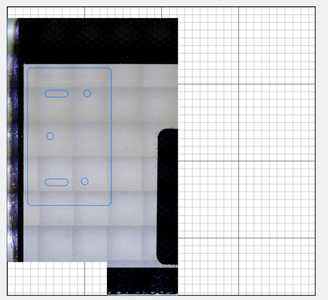

The second layer is the sandwich layer, in this case to be made with 5mm MDF (#0D79F2). This is the layer that will house the magnets, the magnets I am using are 9mm in diameter so there needs to be 9mm holes that line up with the artwork on the front. I'm also making a keyhole style attachment so the key holder can be attached to the wall, so those holes are also added to this layer.
The final backing layer, to be made from 3mm MDF (#F20DAF), just needs the keyholes for the screws when attaching to the wall.

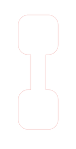

I also designed fobs to be etched and cut from leather (#F20D0D).

Each of the layers was then etched and cut as according to the layers in the step above on my Beambox lasercutter.
I first cut and etched the cover, then the middle sandwich layer, and finally the back.

Step 4: Cut the Key Fobs
While the glue was drying I cut and etched the key fobs from some rescue leather using my Beambox lasercutter.
Note, this part does smell quite terrible and I recommend letting the air vent as long as possible.
It is worth playing around with different settings here on your lasercutter to get the etching effect you are looking for, it's easy to burn the leather and end up with char.
