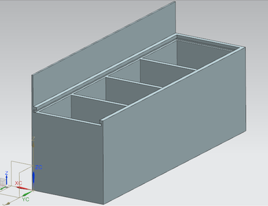

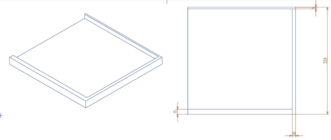

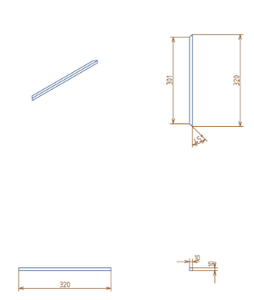

Step 2: Make the Compartment for the Board Games
We’ll saw 3 different mdf laths (5mm) and one bigger piece to cover the compartment
- 15 x 310 x 5 mm (Needs to be thick enough for the screws)
- 10 x 320 x 5 mm
- 5 x 310 x 5 mm (Is smaller, so the board games still fit in the compartment)
- 280 x 320 x 2 mm (to cover the compartment)
After sawing, you can glue them together like you see on the drawing

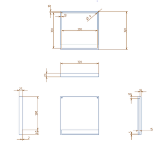

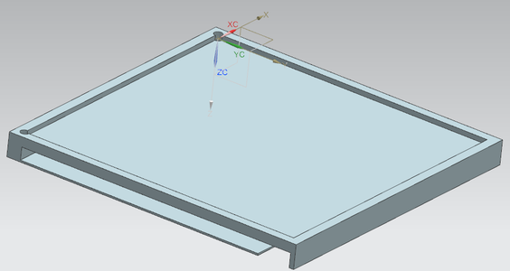

Step 3: Complete the Magnetic Board
Now we’ll need some nails and the hammer.
Lay your compartment on you working platform with the opening above, lay your steel sheet above and then the frame.
Put a nail in every corner of the frame. Do you think it’s not stuck enough, put some more nails in the corner.
To connect the magnetic board to the container, we’ll need to make 2 bigger holes with the drilling machine. Make 2 holes from 9 mm. You can find the dimensions on the drawing

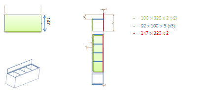

Step 4: Make the Compartment for the Magnetic Pieces
We’ll need to saw mdf wood again:
- 100 x 320 x 2 (x2)
- 320 x 92 x 100 x 5 (x5)
- 147 x 320 x 2
Glue the pieces together like on the drawing. While it’s drying you can make the frame for the cover of the box

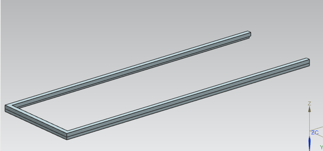

For the frame we’ll need mdf again. This is some precision work because we need some thin laths.
Top frame
- 320 x 4 x 5 (2x)
- 100 x 4 x 5
Glue this laths together like on the drawing. Make an U-form
Bottom frame
- 318 x 2 x 2 (2x)
- 90 x 2 x 2
Glue them in the U-form.
Then glue the 2 frames together, the largest one above.
Glue the frame you’ve just made to the box you’ve made earlier

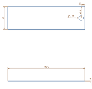

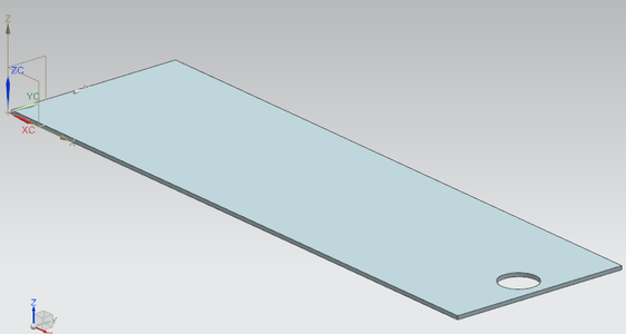

Step 5: Make the Cover
Take the 2mm mdf and mark the dimensions from the drawing.
Then you can saw it. The last thing you need to do is drill the hole. You need this hole to open and close the box
