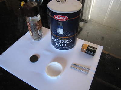

Step 1: Household Materials
1 small circular magnet (can be purchased cheap at any hardware store)
1 small white cap
2 nails
1 9 volt battery
salt
pepper
1 small white cap
2 nails
1 9 volt battery
salt
pepper
