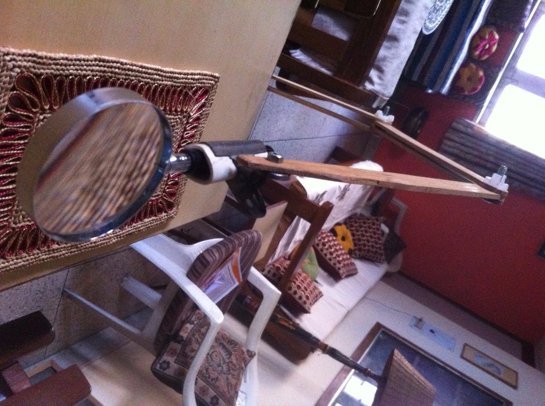

Step 4: Preparing the Wooden Arms
On each of the wooden strips, take points 1.5cm from both ends which run and drill 2 holes along the centre of the strip. Sand the edges to round them up.
Fix the arms in the formation shown in the sketch, where the middle member on the lowermost section can be ignored, but a spacer will need to be fixed in place of it.
Pass the bolts though the holes and fix the wing nuts on the other end. The wing nuts allow manual adjustment of the arm angles.
Step 5: Preparing the Bottom Unit
Take a 5cm long segment of a wooden strip and screw it to a metal G clamp with a 1mm thick bolt. Use a square nut to fix it in place.
Screw a wedge to the top of the wooden strip segment and bolt the lower part of the arms to the wedge.
NOTE: The bolt should be fixed upside down, i.e, the head of the bolt should be on the bottom and inside the clamp. Fix a sponge around the screw so that when it is fixed to a table, it doesn't scratch the surface or wobble on the it.
Step 6: Preparing the Top
Fix the metal paper clamp with a bolt to the topmost arm with the 1/4" wide X 12mm long bolt and clasp it in place with a nut.
Fix a piece of padded flex between the arms of the clamp and paste it in place with an adhesive so that it doesn't scratch the magnifying glass or its handle.
Step 7: Finished Work
You now have a finished magnifying glass stand which has a universal mount.
