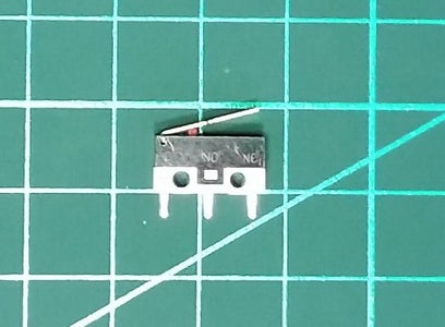

  • limit switch

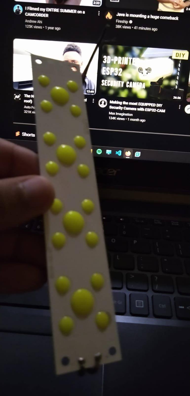

Step 2: Assembling LED Strip
I obtained an LED strip from a local electronics market at a very affordable price, less than a dollar. To protect and enhance its appearance, I designed and created a cover for the strip. Additionally, I attached a power jack to the strip for convenient power connection. It is important to ensure the correct wiring and soldering of the wires to the power jack. To do this, I recommend performing a quick Google search for the specific power jack you have and following the appropriate wiring instructions.
Once the LED strip and power jack are prepared, I proceeded to assemble the various 3D printed parts for the lamp. Following the instructions and images provided earlier, I joined the light holder part to the lamp using superglue. Finally, all the 3D printed components are carefully assembled together to complete the construction of the lamp, as depicted in the accompanying pictures.

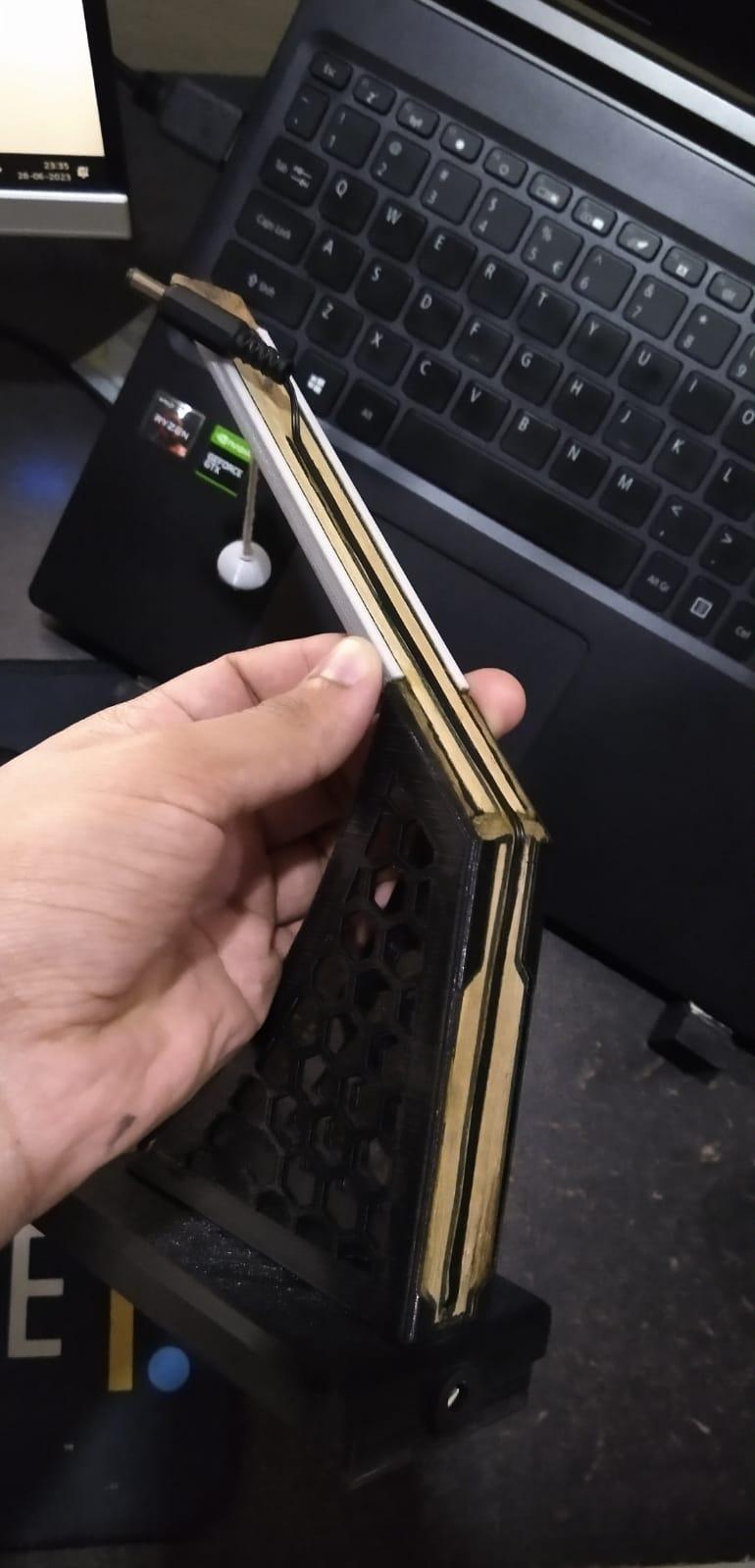

Step 3: Assembling Frame
To prepare the wooden components for the MagnoLamp, follow these steps:
  1. Cut the wood according to the provided dimensions.
  2. Take one side of the wood and grind it at a 45-degree angle.
  3. Insert the smaller wooden part into the vertical section and the larger part into the angled section, ensuring a snug fit.
  4. Securely bond the wooden parts together using super glue.
Next, proceed with the assembly of the lamp as follows:
  1. Attach the middle frame to the bottom base plate using the provided studs. Make sure to align them properly.
  2. Bond the middle frame and bottom base plate together using super glue. Remove any supports used for adhesive purposes.
Refer to the accompanying images for visual guidance throughout the assembly process.
You can now attach the LED strip part that was previously assembled. Follow these steps:
  1. Take the LED strip part that you created, which includes the cover and the attached power jack.
  2. Position the LED strip along the designated area on the lamp where it is intended to be installed.
  3. Ensure that the LED strip is aligned properly and fits securely within the designated space.
  4. Use an appropriate adhesive, such as super glue, to affix the LED strip to the lamp body.
  5. Apply the adhesive carefully, making sure not to obstruct the LED lights or any essential connections.
  6. Allow sufficient time for the adhesive to dry and set according to the manufacturer's instructions.
  7. After this, super glue the wooden side covers on the both side of the wood.
Once the adhesive has fully cured, the LED strip should be firmly attached to the MagnoLamp.

To begin assembling the trigger mechanism of the limit switch in the MagnoLamp, follow these steps:
  1. Refer to the provided photos for visual guidance on how to arrange the parts. Ensure you have all the necessary components ready.
  2. Assemble the parts according to the photos, following the indicated configuration. This includes placing the limit switch in its designated position.
  3. Use superglue to securely fix the limit switch in place, ensuring it remains stable during operation. Follow the instructions provided in the images to ensure correct placement.
