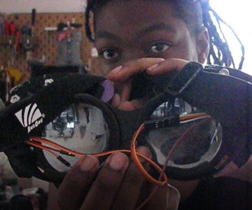

Hey Jayy here, your Favorite Oddity, I made these goggles for fun during a tough time, They became really popular making it on the cover of MAKE magazine issue 76. I was planning to use this build and try going into more of a business. But that's just not me. so I decided to make them open source and share them with the community.

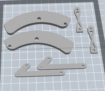

Printing the parts should not be too hard when you have a 3d printer, I have sized everything for my creality Cr-10 but the files should fit most printers. I recommend starting with the “lens base” and “Servo Goggle Holders”
After these parts Are finished, you will want to glue them to the goggle frames using the 6000, glue. I chose this glue because it's strong and flexible. I also recommend having some clips to hold down the parts.

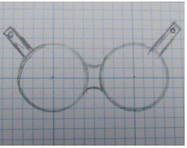

Quick Hint before you start glueing make sure the Lens base pointers are sitting at 1 o'clock and 11 o’clock (or 135 degrees and 45 degrees for you technical people) this way the actually eyebrow will move correctly trust me I have glued them wrong before and had a mess.
  • Added a quick sketch if you’re more of a visual person like myself

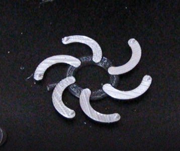

This is probably the hardest part, I got the original design from thingiverse (https://www.thingiverse.com/thing:2019585)
But I did alter the size and thickness for my project. 1st thing you want to do is print out the lens parts.
out you will have to carefully insert the leaves into the holes. Be patient and you may need to file the hole a bit to get them to fit easily. Once you have them insert you fold them in and insert them into the lens. This part may take some time and maybe a bit frustrating at moments but your patience shall be rewarded.

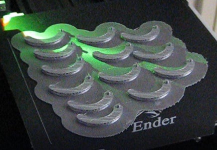

After everything is glued on and secured, I recommend doing a testing, Print out the eyebrow parts, and the pulley hinges.

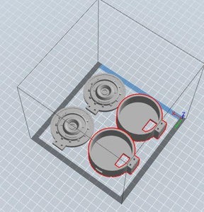

I recommend starting the print for the Circuit cups, these will hold the circuit and the battery for the Goggles

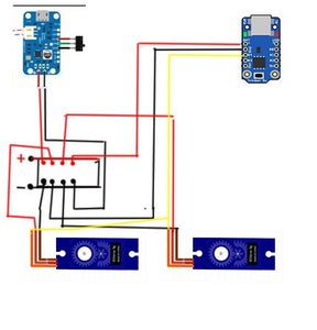

So this is where your tinker/Maker skills come though the diagram for this is a bit weird I daisy chain the signal wires from the Adafruit trinket, here is a quick diagram I drew up
I made a connector from a Permaboard, that way all the devices can share POWER!!
