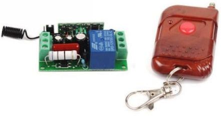

The range of a mailbox alert system should cover the farthest distance from the transmitting the device housed in the mailbox and the receiver unit at the home. Therefore we have chosen a distance of 100 meters to be most effective for many houses and be cost effective too by using a of low cost transmitter and receiver pair from Ebay—Titled product on Ebay is
“AC 110V 10A relay 1CH wireless Smart Remote Remote Switch Transmitter+Receiver” at http://www.ebay.com/itm/AC-110V-10A-relay-1CH-wir...
The remote to be used for the same has only one push button for on and off alternatively . This will help to use contact points from a low cost mercury switch (readily available from ebay at less than a dollar) soldered to the push button points of the remote.The receiver that directly operates from 110 v mains has a relay that can be used for any load.

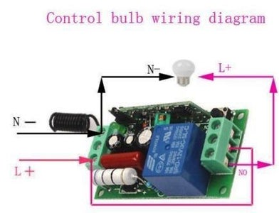

The system uses an alert to notify you when your mail has arrived, by buzzers, bells or a simple mains lamp. The alert load is wired as per the diagram seen here, arranged for the receiver board located in the house duly plugged into the mains supply always.Whenever the transmitter sends a signal the relay operates as long as the door is kept opened by the mail carrier after which the relay drops so also the load.The flag use however on the mailbox requires manual operation.
