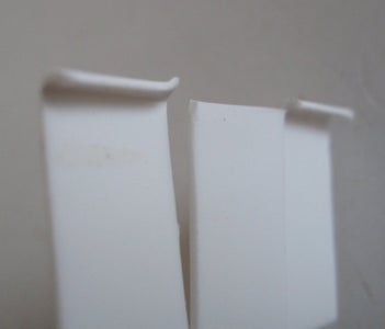

I was thinking of a bit of plastic with a hook bent into the top edge when it occurred to me that a section of an ice cream tub is just the thing.
- I used scissors to cut out a section approx 30mm wide by 65mm long.
- Next I cut off a thin strip off the top flange for the L shape which was going to hook into the mailbox lid.
- In order for the strip to fall out, I cut two slits into the top to create a spring tab in the middle.
- This spring tab has its flange cut off and is bent forward so that it pushes itself off the rim when the box is opened.
