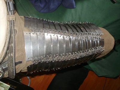

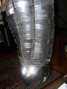

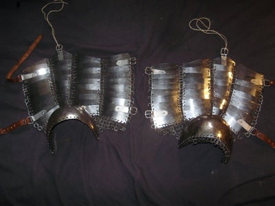

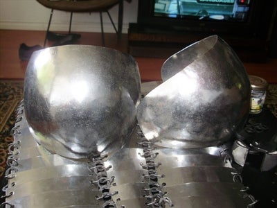

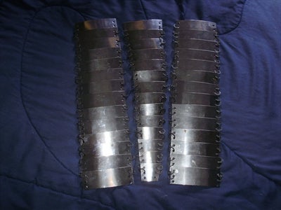

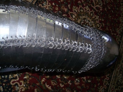

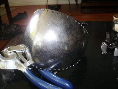

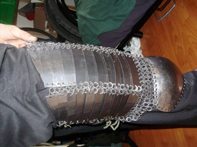

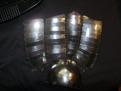

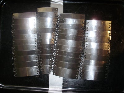

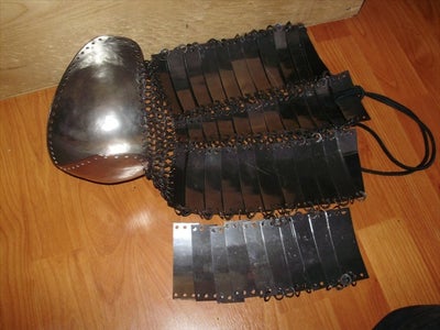

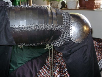

Here is My new leg armour. I opted not to make an instructable for them since they just use a continuation of the techniques in my Maille and Plates Armour instructable.
These are made from 1-1/4" pallet banding again, however i used 9mm flattened wedge rivet rings for the maille(meaning that i had to rivet EVERY ring shut) and a dished 16 gauge knee cop. all the buckles and fittings are hand made as well from 3/4" pallet banding and nails.
