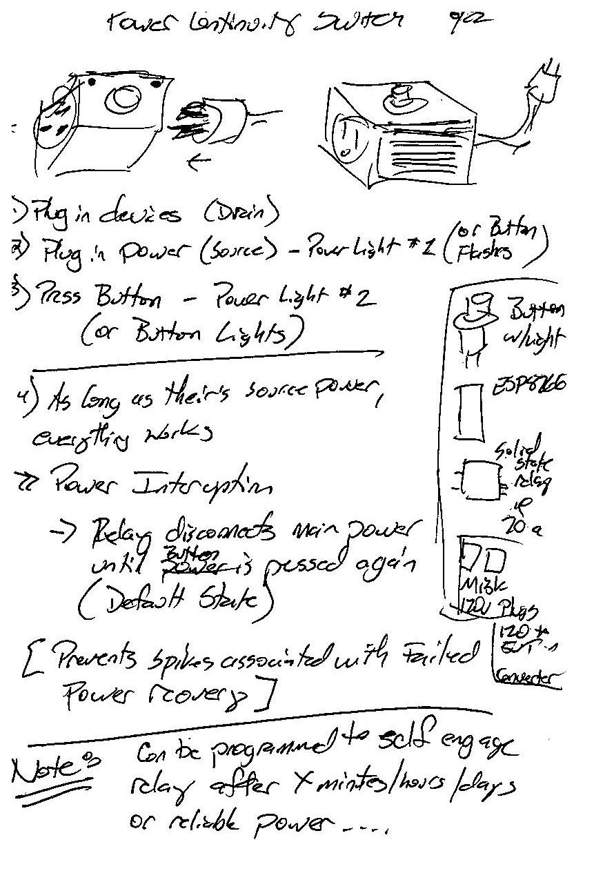

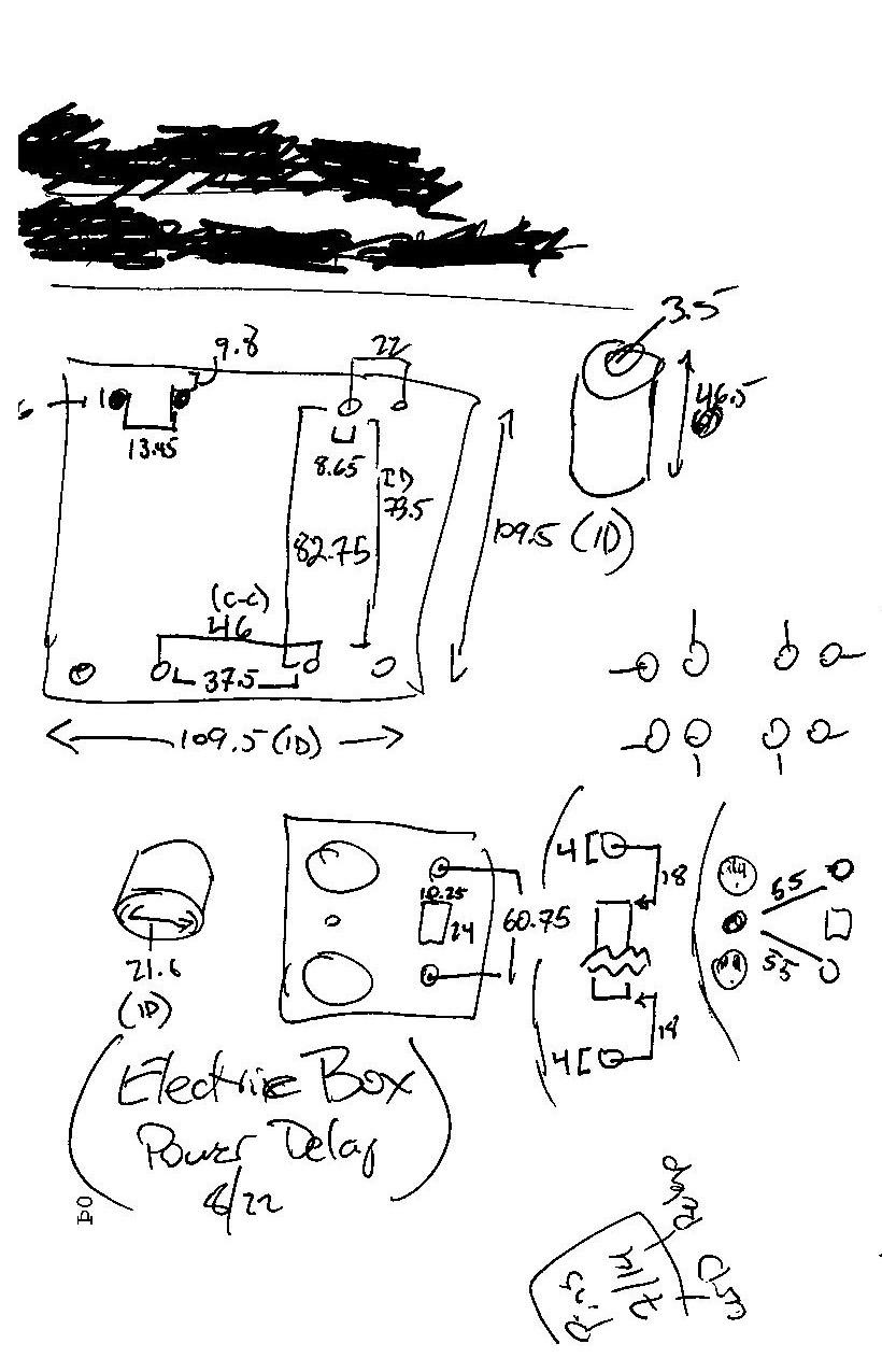

Step 1: The Design

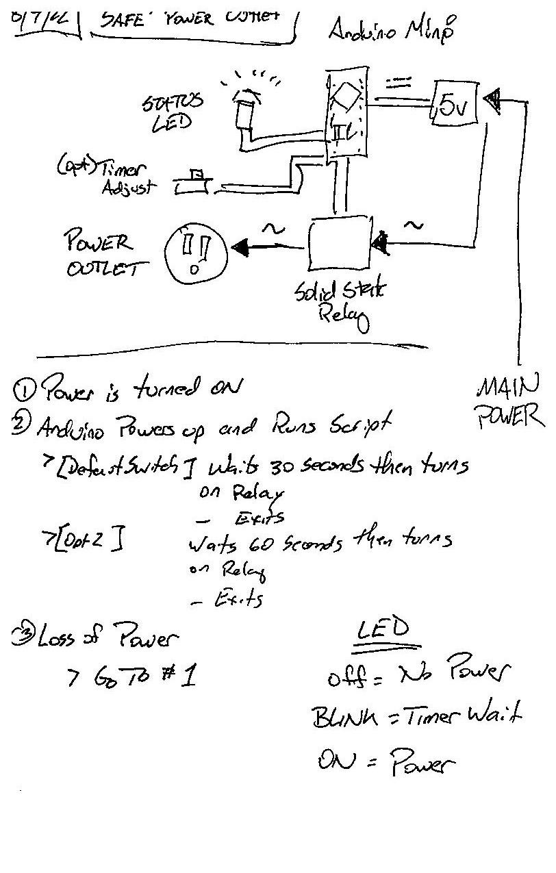

You may or may not have seen any of my other Instructables but everything starts out with some sketches on a half sheet of paper. Original concept to a refined design down to measurements and notes, everything lives on the half-sheet.
My first thought was to have a mechanical button that crosses the relay and once powered the relay would continue until the power drops. Great, simple and no complex electronics. Only problem, I'd have to hit all the manual resets every time the power blips. Did I mention it blips a LOT. So, I nixed that.
How would you design the delay box? Perhaps you'd use a micro controller to run the basic of basic codes. Your code might count to 30, flip on the relay and then exit. Come to think of it, you might even want a visual indicator so you'd have the code flash an LED during the count up (1/2 sec flash and then 1/2 rest) and then go solid when the relay is active.
Really? Me too!!
I wanted something simple to design, simple to build, easy to fix and as cheap as I could make it. It had to power on the load all by itself so I added the micro-controller to my original design. I can change the dwell time and they're not expensive to replace if they fry.

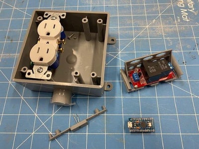

I used a standard double gang outlet box from my LHS (local hardware store) as the main project box. Everything will be in or on this box. It's not the "wall" box that you'd find in a wall rough-out but it's labeled as "water proof". Thick grey plastic.
I used a standard 120v dual-gang outlet but contemplated using a GFI and when I do this again I will.

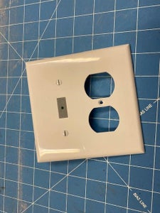

I also grabbed a dual face plate, plastic (non-conductive). One side fit my outlet and the other was for a single switch, which we'll use for the LED.
I had cast offs from other projects so out I pulled an Arduino Micro Pro 5v (HiLetgo) and a relay (10a) from an old Arduino "kit". I believe the green LED and 220ohm resistor also came out of that same kit.
Electrical cables. First off, everyone should have a box full of CAT5 scrap. Great source of scrape cables for low voltage projects. I have some scrap 14 and 12 guage solid wire that I use for wall-power projects but if you strip those power cords you snipped earlier you have a good supply of stranded cable - MUCH easier to use than solid. Just tin the ends to keep the ends from fraying.
I grabbed a small USB charger from the junk drawer and snipped the power cable off of an old piece of junk yet to find its way to the recycler (I snip ALL the cables off of defunct equipment, they always come in hand).
NO, I am NOT a HOARDER! Ok, maybe, just a little...
I tend to use the dual-gang box design because it allows for both the high voltage outlet and the controlling electronics. I like these thick grey boxes because they're sturdy and meant to be used outside of an external support (stud). They're tuff and can hold up to use and abuse. I can also add a single gang to the dual gang if I want separate out the high voltage from the low voltage.

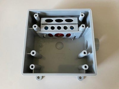

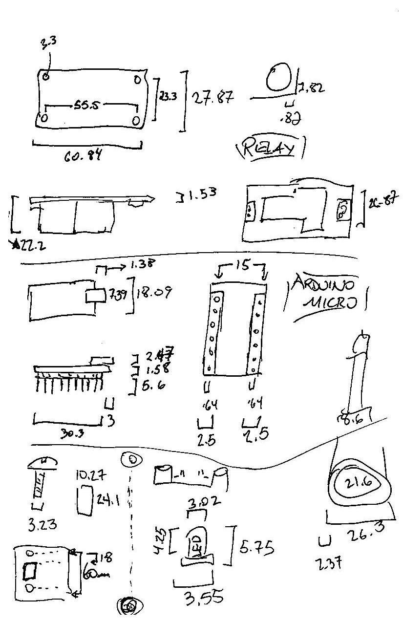

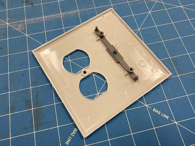

Step 4: 3D Printed Parts

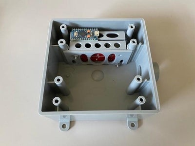

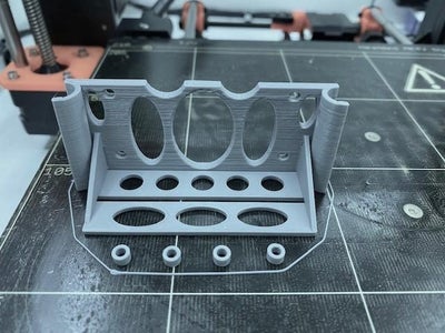

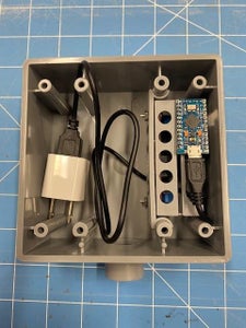

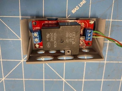

With this build I strayed from my standard methodology of just jamming things together and decided to print some mounting hardware. There are two pieces, the electronics holder and the LED holder.
Electronics Holder

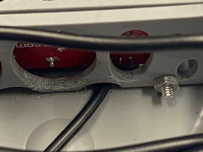

The relay and Arduino are mounted to a bracket this between two of the boxes mounting poles and does a decent job of separating them from the high voltage, so to speak. The relay mounts to the bracket with some small nuts and bolts while the Arduino stradles bracket's top section, held in place with a dab of hot glue.
The bracket is designed with some holes and dimples to allow the passage of the different wires and is held in place with friction. Push it all the way down and it will stay there. You can glue it in place but I wanted to be able to remove everything in case something fails.

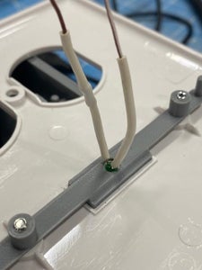

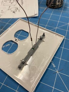

LED Holder
The LED holder of course holds the LED but it also pulls extra duty by filling the space on the right side of the cover plate (keeps it from rocking back and forth once screwed to the outlet) and has pins that fit into the box's mounting holes, to keep everything from moving.

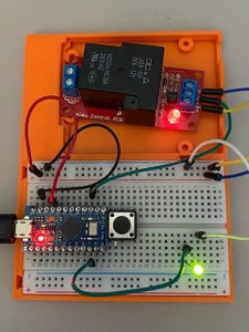

Step 5: TEST EVERYTHING!
This is probably the most important part of any project - TEST EVERYTHING!
Before you start screwing everything together you'll want to test everything you can. Does the code work? Are you getting the right voltages? Is ground good across everything? And very importanly, is anything crossed or shorted? If you apply voltage, are you going to see a flash that lets out all the magic smoke in your IC?
In all seriousness, get a meter and run a test on everything before you plug anything in, especially if you're mixing high and low voltages (ya gotta keep em seperated!) and are keeping them in close proximity. You'll want to make sure nothing is shorting on anything else, everything is projtected, covered, and non-exposed. Use electrical tape, use shrink wrap tubing, make sure that everything is routed properly and not just shoved together. Make sure all the screws are tight and that all the solder points are secured. You really don't want anything coming loose and burning everything down, let alone causing immense pain all the while it's killing you.
Test, connect, test, assemble and test again.

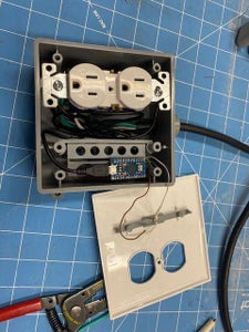

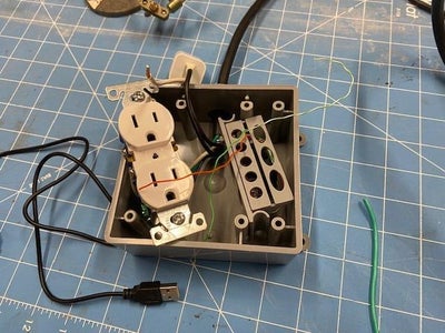

Step 6: !Putting It All Together!
The project has gone from concept to design to prototype to this, final assembly.
This phase was very straight foward and required little or no deviation from the plan.
Assemble the Main Bracket
- Attached the Relay and run main power cables from the relay, through the routing holes out to the box.
- Attach the Arduino
- Plugged in a short USB-USB Micro cable to the arduino for power.
- Soldered 24g wire to the legs of the Arduino for power, ground pin 7 (LED) and pin 14 (relay)
- Connected ground, power and pin 14 wires to Arduino
- Routed the ground and pin 7 out of the bracket for the LED
- Small dab of hot glue to keep the Arduino in place
- You'll see that the pins fit through the opening at the top of the bracket and it sits flat on its circuit board.
- Insert bracket into box, carefully routing wires
LED Holder
- Insert LED holder into the cover plate
- Attach with screws
- Insert LED
- Solder wires onto LED (with resistor on the positive side)
- Cover with Heat Shrink
- Dab hot glue to keep the LED in place

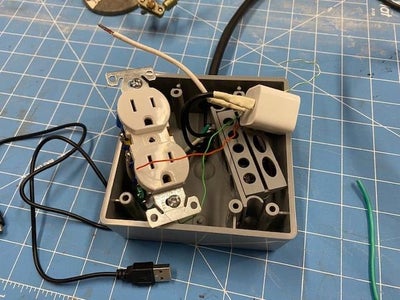

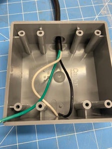

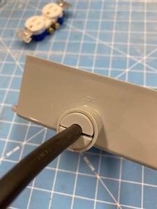

Insert Power Cord
- Strip off outer jacke of power cable by six inches and insert into box
- User (2) power cable chocks to secure cord into cable opening on box
- Use some super glue to make sure they stay put

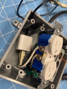

USB Power Adapter
- Attach HOT from main power and HOT from RELAY to one leg (Shrink Wrap)
- Second leg, run NEUTRAL cable to NEUTRAL on gang outlet (Shring Wrap)
- Use hot glue to secure blow gang outlet
Gang Outlet
- Screw GROUNDto outlet
- Screw HOT from Relay
- Verify NEUTRAL from USB Charger
- (TEST EVERYTHING!)
- Secure gang to box

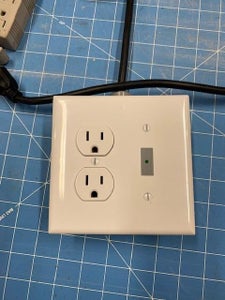

FINAL
- Secure face plate
- Test that there are no crossed wires on main power
- Plug into outlet
- LED should flash for 30 seconds
- After 30 seconds the LED will go solid and you'll hear a "click" from the relay
- Test voltages
Walla, she is done!
