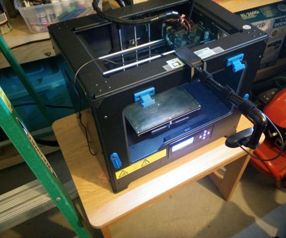

Step 2: Printing the Case and Mounting Parts
You can get the 3D models for this project from Thingiverse:
http://www.thingiverse.com/thing:1474924
Once you have completed printing you can go ahead and mount the panel mount plug and secure it with the M3 nuts and bolts. The receptacle, switch, and terminal block are snap fitted to the case and the fuse is tightened with the nut that comes with it.
