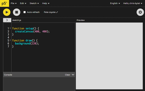

  • We can access the p5 Web Editor through this link: https://editor.p5js.org/
  • Note that in order to save your sketches, you will need to make an account (button found on the upper right corner)

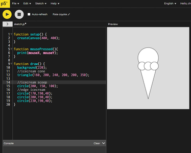

  • Once you create your account and return to the Web Editor, you can see there are two functions already in the new file: setup() and draw(). These functions are explained above in the image 2 notes. For our purposes we will mostly use the draw() function.
  • Before we work on draw(), we can create a function mousePressed(), which will print the x and y position of your mouse when you click on a position on the canvas (refer to image 3). This is helpful when determining where you'd like to place certain shapes on the canvas later.

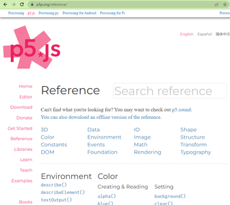

  • The p5 reference can be accessed here: https://p5js.org/reference/
  • The reference is very helpful in seeing what functions and tools you would like to use in drawing your icon. The functions under “Shapes” will be the most important because they will give you the shapes available to create your icon.
  • The reference can also inspire you to choose functions to later add minimal details to your icons that can help to keep them visually consistent

  • As shown in the image above, I am first focusing on the ice cream cone, so I choose to use the triangle() function first and overlap the circle() functions to create a basic ice cream cone.
  • Further explanation on individual functions can be found in the p5 reference

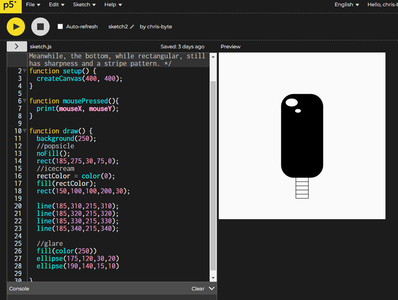

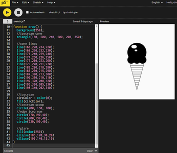

  • Once you have your basic icon shape done, you can look through the functions in the reference to see if you can use any to create details on the icon that can be repeated in your other icons
  • For mine, I chose to use line()  to create stripes on the cone, fill() to add color, and ellipse() to draw a little “glare” on the top of the ice cream cone. The purpose of adding these is so I can implement the stripe, color, and glare details in the other icons, without changing the meaning of other icons.

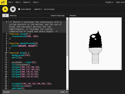

Step 6: Other Icons
  • Now that you know how to draw shapes on the canvas and use the reference to find helpful functions, you can click the “File” button on the top left and create a new file to move on to your next icons.
  • You can repeat steps 3 to 5 in choosing how to create the icons, the most important thing to keep in mind is to continue a common trend, pattern, or detail in order to maintain consistency in your icons.
