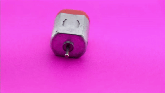

This turntable has a geared motor and speed control option, if you want a slow-rotating object video or a fast one this device has got you.
If you want to build this turntable I have provided all details from materials to circuit the only thing missing is your time to build this :)
