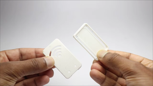

3d printed case for nodemcu(optional)

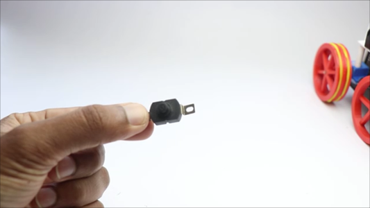

Switch

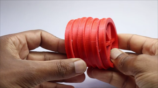

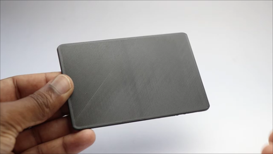

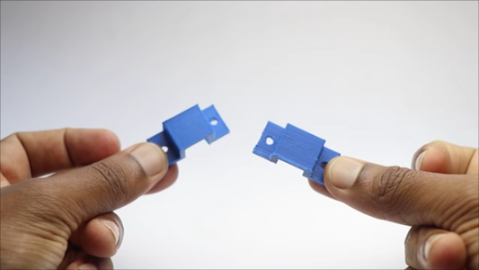

There are 4 main parts in the design, Wheels, Motor holders, Base of car and the elevated holders for battery.
I have used ultimaker cura for slicing the stl files and i recommend you to use the stl files on the same slicer to assure complete success for the 3d print of these things.
Just download the below files and open it on cura, there are no parts that need supports or adhesion, make sure you are placing the designs on the print area like i did.
Print the model with pla filament and the choice of color is left to you.
You can see the color combination that i have used to print the parts, it looks cool though.
After you have all the parts ready we can move ahead on assembling the parts one after the other, let us start from the base of the car.

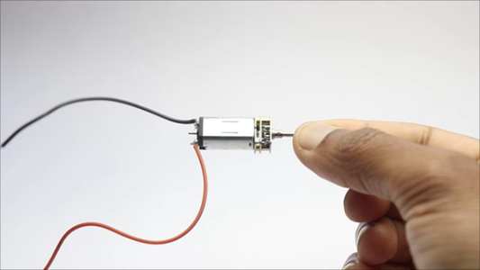

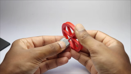

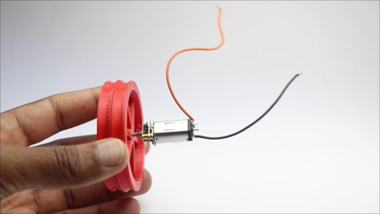

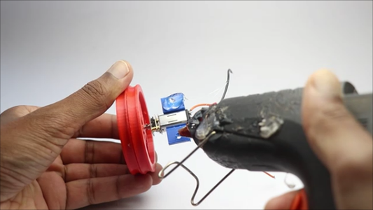

For the front wheel or we can say this as powered wheel i will be using N20 motor to the shafts of which we are adding wheels
I found that adding 2 wheels instead of one helps the wheel to utilize the power coming out from motors.
Glue the wheels on its sides and later connect to the shafts of motor, Repeat the same step for other motor too,

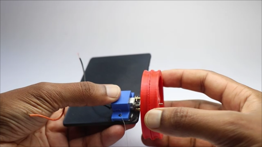

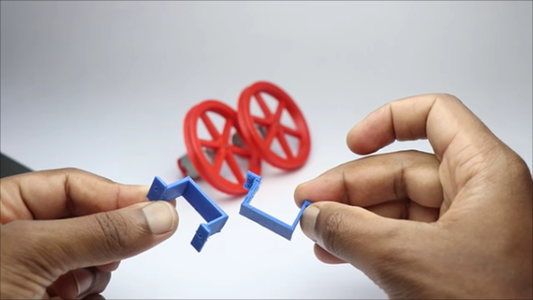

Now add the Bracket or known as holder to this motor and couple them to the car base, In my case i found that hot glue works best here.
Add the other motor to the front base, this completes the front wheel drive assembly that drives the entire car.

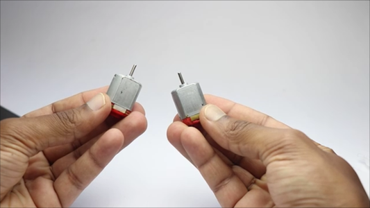

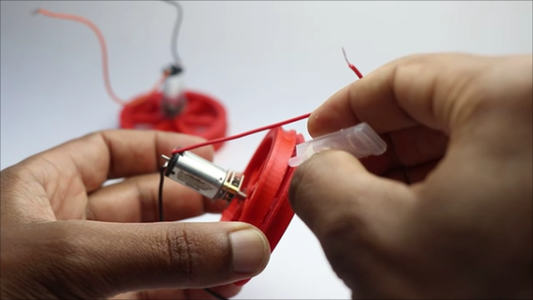

For the rear wheel or called as back wheel i will be using the toy dc motor.
You may now think why i used this dc motor, the answer is simple, for the smooth movement of the wheels i have used this alternative this skips the use of complex other movement mechanism like shafts.
Glue the holder to the motor and later glue the entire thing to the base of the car, repeat the same step for other side too.

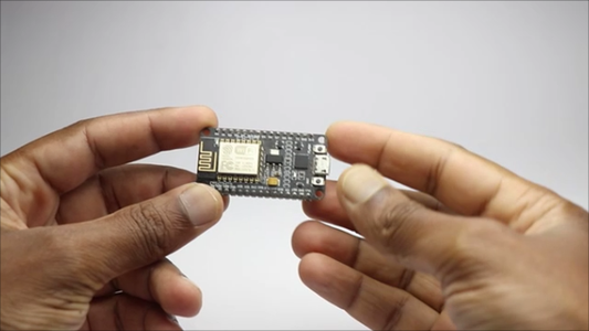

The circuit used in this project is given here, For a beginner these connections might seem a little complex, To make it easier i will be explaining them below.
ENA to D5
ENB to D6
IN_1 to D8
IN_2 to D7
IN_3 to D4
IN_4 to D3
The terminals of dc motor are connected directly to the motor terminals on the motor driver.

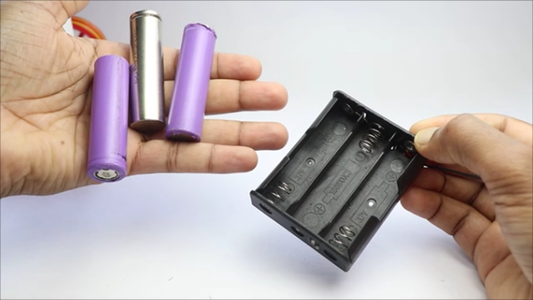

The power supply that i will be using is from lithium ion battery pack, The 3 batteries provide 11.2v dc power.
Gnd of the battery is connected to Gnd pin of the driver and the Gnd of here is connected to gnd of Nodemcu.
The 11.2v pin is connected to 12v pin of driver and the 5v pin from driver is connected directly to the Vin pin of nodemcu.

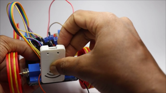

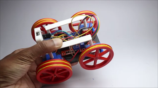

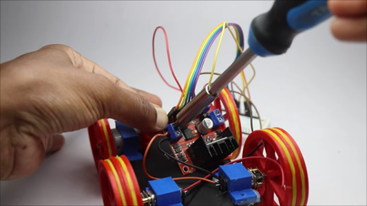

Place the entire circuit on the base and use superglue or hot glue wherever necessary. Connect the terminals of the motor to the driver and secure the screws.
As per my design the electronic components come with standard size, So there should be no problem of misfit.

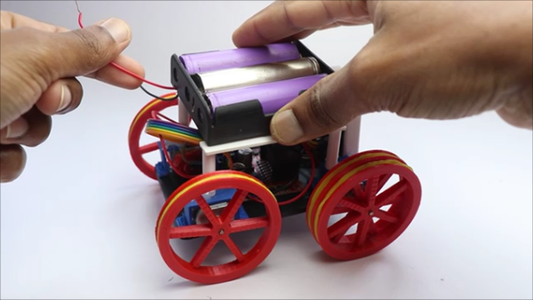

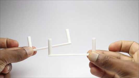

Since we have no space left at the base of the car i thought of placing the battery after making some elevation.
To elevate the height i will be using 2 small pillars that will be placed ontop of the motor frames, Use hot glue or superglue to add this structure.
Now place the battery on the top of this structure, i have added a tiny amount of hot glue to the base of battery holder so as to hold them to the structure well and not cause any movement when the car is working.

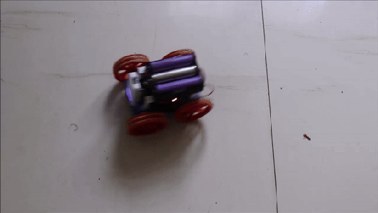

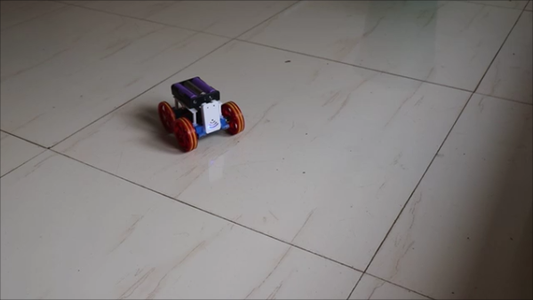

Turn on the car first and later turn on the Wifi on your phone and connect to Robohub network, There will be no need of any password to connect.
Open the app that has all the control button for this car, if you face any issues close and open the open and again connect to the wifi network this will solve your issue.
Now take your car for some spin! The speed of the car can also be adjusted on the control panel (Slider button given at the bottom)
Make a note that if your car has some trouble moving add few more rubberbands, This add more grips to the wheels thereby increasing the friction.
