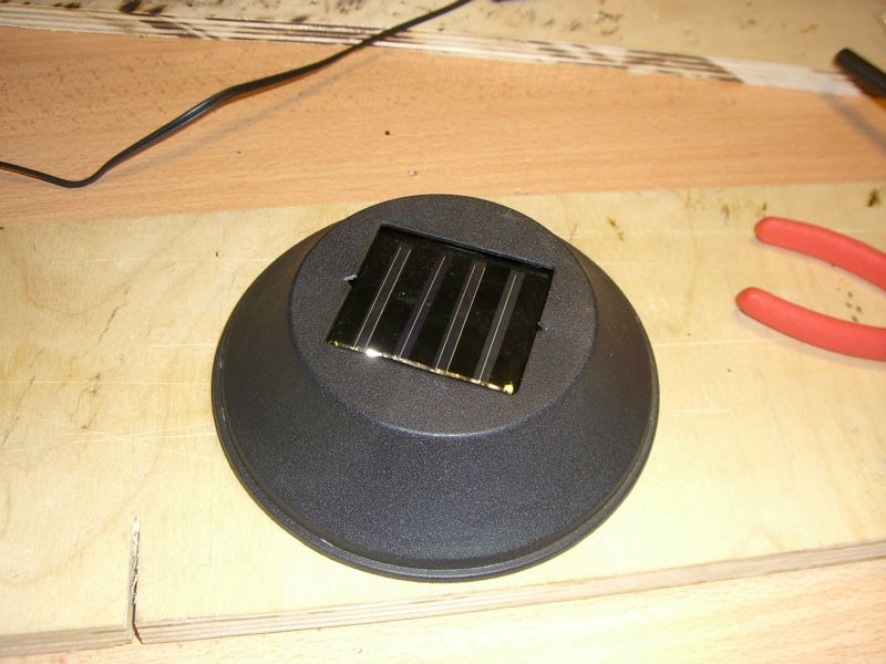

Step 2: Re-wire Your Light
You will need to gut your solar light. Pull it all apart until all you have is the solar panel, circuit board and battery holder.
Also remove the batteries.
All the wires that are currently attached are not only too short, but they will also break off as soon as you move things around.
So, you need to take them all off and solder on new wires that are longer.
