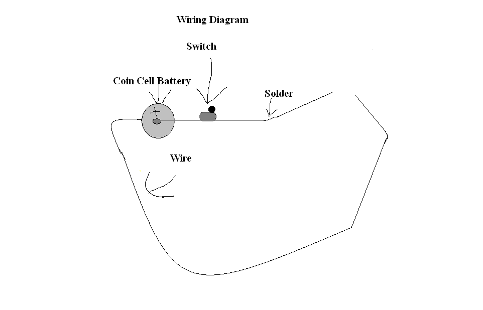

To do this you basically connect 2 wires to the battery. Connect the switch to one.
Step 3: Construction Step 2
If you take 2 pieces of duct tape and stick them together you make a big sticky piece of tape.It should be around 5x3 in. You poke an LED's leads through the duct tape. Then solder the positive and negative wires to the LED. An LED's long lead is positive and its short is negative. Also, an LED's flat side is negative. Once you have those connected, turn on the switch to check if it works. Then stick the LED's leads to the tape and bend the wires 90 degrees so it faces strait out. Then stick the switch on the top edge of the tape. Then stick the wires down onto the tape. Make another 5x3 piece of tape on top to sandwich the electronics. Cover it with a few layers to be less bumpy/wrinkly.
