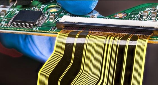

Want to simplify this circuit? Buy PCBs for your electronic projects from PCBWay.
Why them? They have provided me with the best PCB and The quality is just amazing compared to other providers in the market
A revolutionary solution that combines the best of both rigid and flexible circuitry to elevate your electronic projects to new heights.
With their expertise in advanced manufacturing techniques, they offer a seamless integration of rigid and flexible components, ensuring enhanced reliability, durability, and space-saving benefits
Check Here for Rigid-flex Pcbs
I bet you have not seen anywhere such assembly capabilities, Check here to know their best in-industry assembly techniques

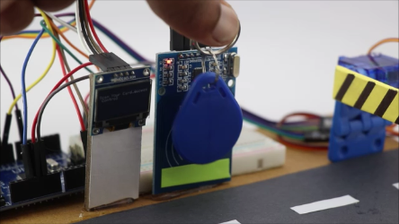

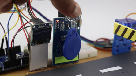

Open the serial monitor and Tap your registered RFID tag on the RFID module, and you will get the UID of your TAG.
In the code edit the default uid with your uid and reupload the code.
Now test the circuit by tapping on the registered tag, the servo should open and close accordingly.

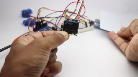

OLED display will show messages like "scan your tag here", "access granted" or "access denied" based on the RFID tag scanned.

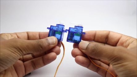

Since the servos are moving part of our project it has to be supported with a strong base and with some elevation.
I used 3D-printed blocks that served the purpose for me.
Add a drop of hot glue and fix it on cardboard later glue the servos.
Repeat the same for other servos too.

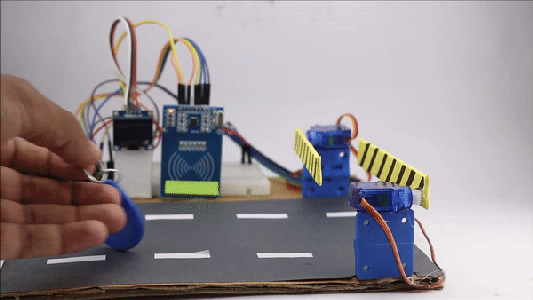

I made a road-like object using black paper and white strips.
Glue the road to the cardboard base, and give the project a final touch by attaching the barricade to the micro servo horns
To make the barricade you can cut strips of cardboard, paint it with black marker and add strips of yellow paper.
By the end of this step our project is ready for testing
Step 5: How to Use
I used a USB power supply to power this project, connect to a power bank, and wait for the OLED to display the message "Scan Your Card"
As I mentioned earlier when you tap the RFID reader with the registered tag, Servo moves resulting in the gates open
The gate remains open for a certain time and later it closes automatically, you can also change this time(just make changes in the servo delay part of the code)
