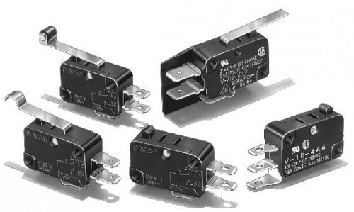

3. Bump switch ( Salvage from old food mixers )

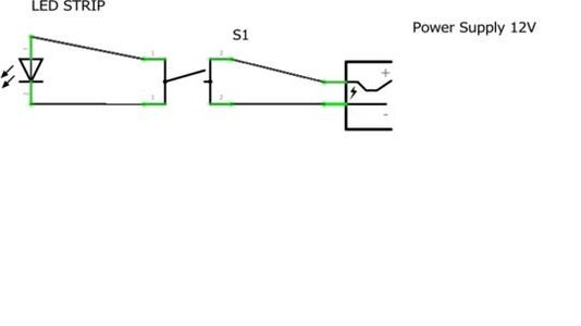

Step 2: Circuit
This is very basic circuit suitable for beginners and people looking forward to lit up their clothes cupboard .
If you have a new LED strip , you can simply remove the tape from the back of it and stick it to the rod instead of using the double sided tape .
Connections :
1. Join the +ve from LED to bumper switch (NC -Normally Close position) .
2. Joint the -ve of LED to -ve of Power Supply .
3. Join the other bumper switch to Power supply to complete circuit .

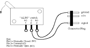

NOTE : The wire I attach to in Bumper Switch is in Normally Close position that is when free it closes the circuit .
That is When Free , when the door is open .
Attach the LED to the back side of the rod so that it is not visible , giving the perfect ambience .
