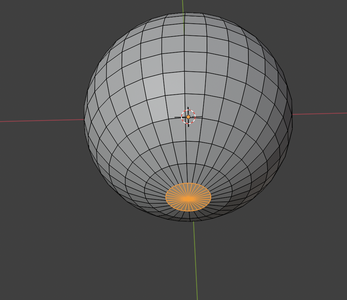

  7. Select the bottom faces, then press G, then Z, then type .1, and press Enter.
  8. This stretches the sphere vertically (to 40cm tall), giving it an oval balloon shape.
  9. Press Ito inset the faces, then move the mouse slightly inward.
  10. Press O to turn off Proportional Editing.

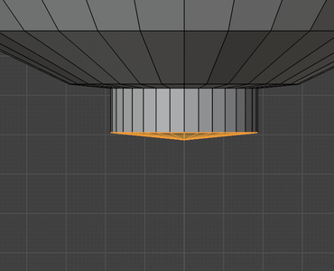

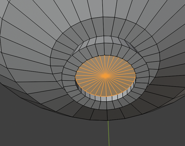

  11. Press E to turn on extrude, then type .05, and press Enter.
  12. Now we are starting to form the tie at the base of the balloon.
  13. Press S to scale and scale the base up slightly.
  14. Press Ito inset the faces, then move the mouse slightly inward.
  15. Press E to turn on extrude, then type .05 then -, and press Enter.
  16. Feel free to adjust the balloon's shape to your liking! I went back and added a lip (where the band at the lip of the balloon) and a neck (leading up to the lip).

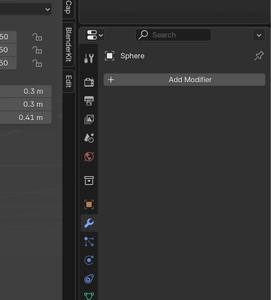

  18. Go to the modifier panel, and add a Subdivision Surface modifier.
  19. To make it smooth, go to Object → Shade Smooth.

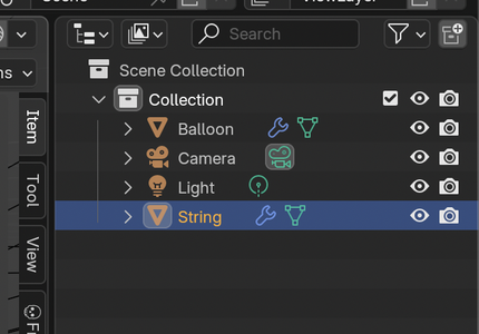

  20. In the Outliner panel (top right), double-click the sphere’s name and rename it Balloon.

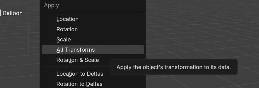

  21. Press CTRL + A and click Apply Transforms
  22. Take the balloon's current position, rotation, and scale and make those the new defaults (the new zero point or 1x scale).
  23. This makes sure that when we include it in our Geometry Nodes further on that the balloons don't come in larger than expected (or some other transform).

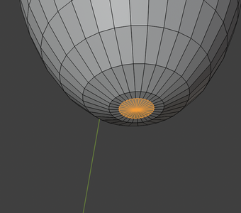

Next, you’ll add a string hanging below the balloon. Using a curve makes it easy to adjust later.
  1. Select the balloon and press Tab to go into Edit Mode.
  2. Select the edges around the neck of the balloon and press CTRL + D.
  3. This will duplicate the edges and will represent the top off the string.
  4. Press S to scale and scale the top of the string up slightly.
  5. Press P to and click "Selection" to separate the string from the rest of the balloon.
  6. Press A to select all, then press E and right click.
  7. This will cancel moving the mesh you've just extruded.
  8. Press S to scale and scale the string up slightly.
  9. This extrudes the base of the string and creates faces. We need these faces later on for our simulation.

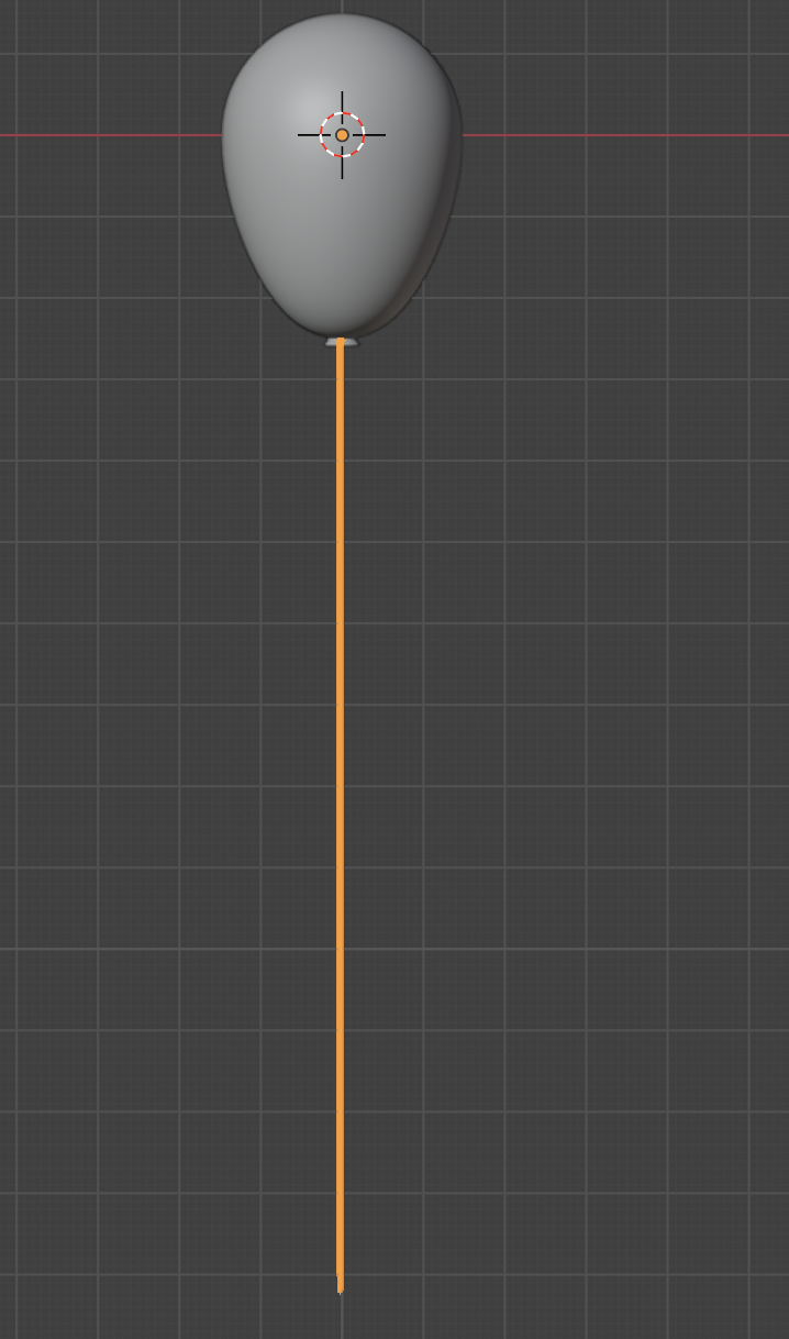

  10. I've included an image with X-Ray mode turned off so you can see what it will look like.
  11. Now, select one edge and press E and extrude it a bit.
  12. Repeat step 9 and form a basic shape of the string.
  13. I just extruded out and then down (as you can see in the image)
  14. Alternatively, extrude the full length of the string and then press CTRL + R to add an edge loop. Before you left click, scroll the mouse wheel to add more edge loops. Once you have the amount you'd like, left click. In retrospect, I'd recommend this approach over the first!
  15. Press Tab to exit Edit Mode.
Now you have both parts of the balloon: the main shape and the string. You can adjust their position later if needed.

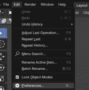

By Default, Cell Fracture isn't activated in Blender. So, you'll need to add the Add-On.
  1. Go to EditPreferences.
  2. Click on the Get Extensions tab.
  3. In the search bar, type "Cell Fracture".
  4. Click Install
  5. Click on the Add-ons tab.
  6. Make sure that the box is checked next to Object: Cell Fracture so that it is enabled.
  7. Close the preferences window.

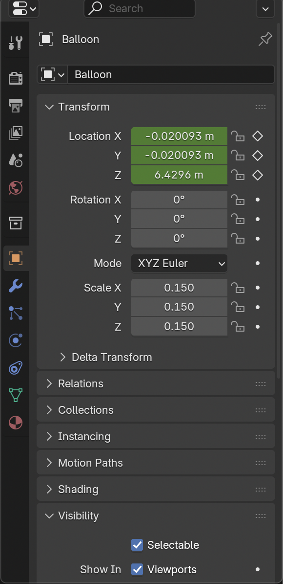

We’ll make the balloon rise using keyframes. You can also add a slight wobble to make the balloon drift naturally.
Animate the Vertical Rise

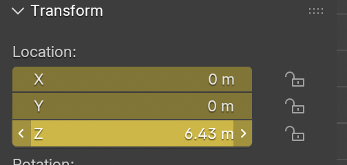

  1. Select your Balloon object.
  2. Move the timeline to Frame 1.
  3. Press I → Location to save the balloon’s starting position.
  4. Move the timeline to Frame 200 (or however long you want the balloon to float).
  5. Press G → Z and move the balloon upward.
  6. Press I → Location again to save the new position.
Expected Result: Press Spacebar to play the animation. The balloon should rise smoothly from the starting position to the higher position.

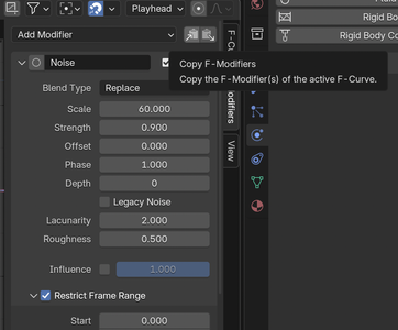

Optional: Add a Small Drift
To make the balloon feel more natural, you can add slight horizontal movement:

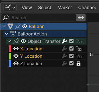

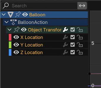

  1. Open the Graph Editor (found in the top-left corner of a viewport panel).
  2. Open the Balloon Transformations, and select the lock icon
  3. Select the X or Y location curves of the balloon.
  4. Right-click Add F-Curve Modifier → Noise.
  5. Adjust Scale (how quickly it drifts) and Strength (how far it moves sideways).
  6. Since the balloon will explode at the 200th frame, I added used the Restrict Frame Range to prevent the noise from
  7. Press Spacebar to preview.
  8. Expected Result: The balloon rises while drifting gently left and right. You can skip this step if you prefer a perfectly straight rise — it’s optional.
  9. Optional: Add noise to the Rotation if you'd like add some more realism!

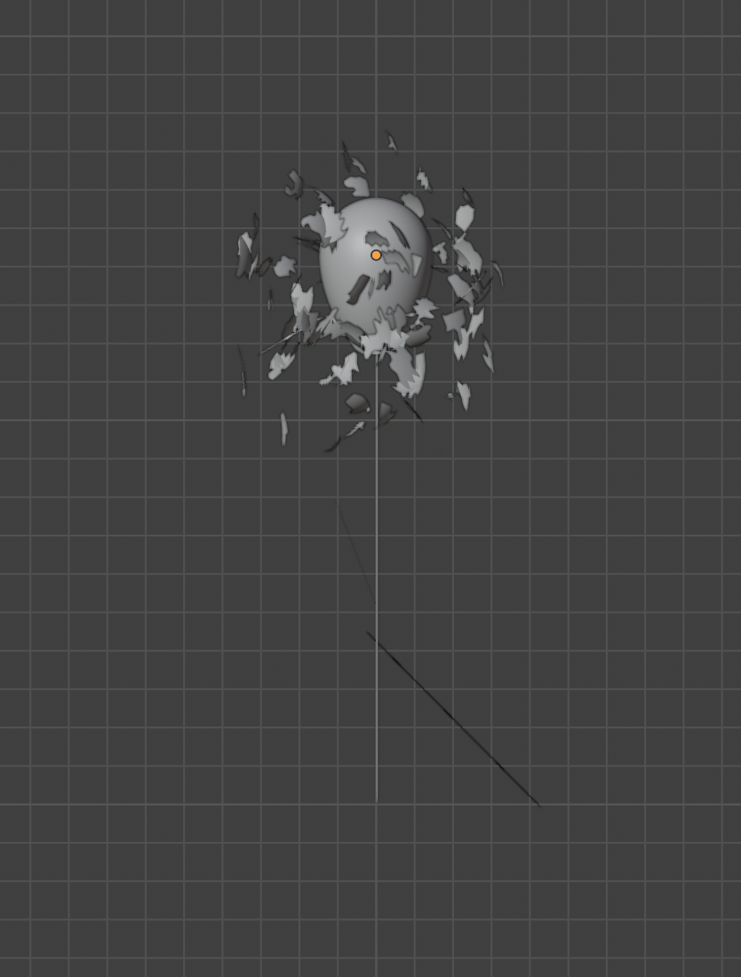

Step 7: Make the Balloon Pop
Now we’ll make the balloon pop! This step involves four parts which are all linked together:
  1. Duplicate the Balloon for the Pop
  2. We'll need a version of the balloon that will break apart while keeping the original balloon for the floating animation. This lets us swap the visible object at the right moment for a smooth pop.
  3. Move the timeline to the frame where you want the pop to happen (e.g., Frame 200).
  4. Select your rising balloon and press Shift + D → Right Click to duplicate it in place.
  5. Rename the duplicate to Balloon Pop.
  6. Since I put this step after the animation step, you'll have to delete the animation!
  7. To do this, just delete the keyframes! (Select the keyframe and press X.)

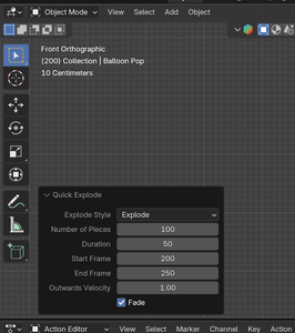

  8. Shatter the Balloon
  9. Using Quick Effects
  10. With Balloon Pop selected, go to Object → Quick Effects → Quick Explode
  11. Set Source Limit to around 50–100 to control the number of pieces.
  12. Animate the force to create a quick explosion by setting the velocity and starting/ending frames of the explosion.
  13. Click anywhere outside of the window
  14. Using Cell Fracture:
  15. Cell Fracture breaks the balloon into shards that can be animated independently. More shards give a realistic explosion effect, but too many can slow your computer.
  16. With Balloon Pop selected, go to Object → Quick Effects → Cell Fracture.
  17. Set Source Limit to around 50–100 to control the number of pieces.
  18. Click OK.
  19. Add Physics for the Pop (Cell Fracture Only, Not Pictured Above)
  20. Without physics, the shards would fall in place or remain stationary. The force field simulates the sudden outward push of a balloon popping, making the explosion realistic.
  21. Select all the shards (right-click the new collection → Select Objects).
  22. Go to Physics Properties → Rigid Body.
  23. With all shards still selected, go to Object → Rigid Body → Copy from Active so every shard behaves the same.
  24. Add a Force Field inside the balloon shards: Shift + A → Force Field → Force.
  25. Animate the force to create a quick explosion:
  26. Frame 199 → Strength = 0 → press I to keyframe
  27. Frame 200 → Strength = 1000 → press I
  28. Frame 201 → Strength = 0 → press I
  29. Swap Visibility Between Balloon and Shards
  30. This “visibility swap” is the trick that makes it look like the balloon pops instantly, instead of fading or overlapping with shards. It keeps the animation clean and believable.
  31. You'll see similar tricks in animated movies!
  32. We need the intact balloon visible until the pop, and the shards visible right at the pop frame:
  33. Hide the shards initially: Frame 199 → toggle Eye/Camera icons off for the shards collection → I to keyframe. Frame 200 → toggle Eye/Camera on → I keyframe.
  34. Hide the intact balloon at the pop: Frame 199 → visible → I keyframe. Frame 200 → toggle off → I keyframe.
Expected Result:
  1. You should now see the balloon rise.
  2. At the pop frame, the intact balloon disappears and is replaced by shards that explode outward realistically.
  3. The timing, shard count, and force strength can all be adjusted to get the pop effect you want.

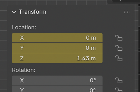

  1. Select the Camera.
  3. Press I → Location & Rotation to keyframe the starting position.
  4. Move to the last frame (after the pop).
  5. Move or rotate the camera slightly to follow the rising balloon or reveal more of the scene.
  6. Press I → Location & Rotation again.
I had the balloon float begin and then once it entered the camera frame, the camera moved with the balloon until it exploded. I've included a picture of the keyframes I used for you to see!

Step 11: Congratulations! Your Balloons Float and Pop
You did it! By following this instructable, you’ve:
  1. Modeled a balloon and string from scratch.
  2. Animated the balloon rising smoothly using keyframes.
  3. Created a realistic balloon pop using Quick Explosion(or Cell Fracture).
  4. Added materials to make your balloons bright and shiny.
  5. Set up a simple background and camera animation for a polished final look.
  6. Rendered your animation into a video ready to share.
