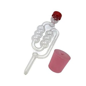

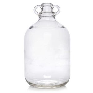

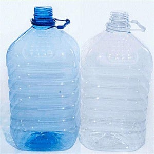

Demijon will be needed for fermentation. You can use a glass demijon or as a cheap alternative, a 5L plastic water container with a screw on lid. The plastic containers have a wider neck so a demijon drilled bung for a water trap or 'bubbler' will be too small. A hole can be made in the cap for a snug fit onto the bubbler. Applying a piece of BluTak around the base of the bubbler will create a seal to keep any dust or fruit flies out. Tape will work too.

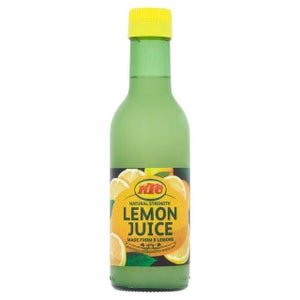

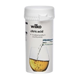

Citric acid is needed to curdle the milk, separating the whey from the curds. Citric acid is readily available either online or from high street shops.
Wilko stocks a range of homebrew equipment including citric acid, a tub of 50g is about £1.25. Squeeze the juice from a lemon or use a couple of dessert spoons of ready made lemon juice.

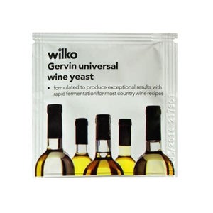

Yeast is sprinkled dry out the packet onto the surface of the whey and honey mix when it gets to about 20C as the last step. Don't be tempted to rush and pitch when the liquid is too hot it will damage or kill off the yeast giving a poor fermentation. Stirring in isn't needed just leave it to rehydrate and start turning all the sugar into alcohol. During fermentation, the yeast eats sugar squirts out ethanol (alcohol) and burps CO2.
The CO2 will build up pressure in the fermentation vessel if it is sealed, causing it to explode. Seriously, it can explode! Make sure you fit a fermentation water trap to your demijon or bottle.
For Blaand I use either Wilko Garvin brand dried wine yeast or EC-1118 champagne yeast. You can use ale yeast like SafAle US-05 or other brands. Ale yeasts normally 'top out' at about 12% ABV so you will end up with a slightly sweeter and lower alcohol wine than using a wine yeast. Champagne yeast will normally ferment all the sugars available giving a quite dry, crisp finish to the wine. If you want to carbonate making sparkling wine, champagne yeast is what you want. Garvin wine yeast is quite similar but not so effective at carbonation or such a dry finish.
You can use bakers yeast too, all yeasts eat sugar and spit out alcohol! Blaand will have an ABV of about 12-15%. Bakers yeasts are not designed to produce alcohol and have a lower tolerance than wine or ale yeast so you may end up with a very sweet lower alcohol wine. Unless of course, that is what you want!

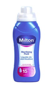

Sterilisation is important to remove wild yeast and bacteria from your fermenting vessel. We're creating a perfect environment that has lots of food (sugar) and nice and cosy for yeast to be healthy and active so we only want the right yeast to be living in our wine. There are a lot of products available specifically for brewing on the market. I use StarSan for beer and wine making because I use a lot of it and it works out cost effective. If you're just trying stuff out for fun on a small scale, in the UK Milton sterilising solution used for baby bottles works just as well. The downside is it takes longer to work and it is chlorine based so needs a thorough rinse with clean water to get rid of the smell and taste.

Sterilising solution (StarSan, Milton liquid or tablets) Drilled bung to fit demijon and airlock

Fill your demijon with 4L of water and mix in the right volume of your sterilising solution as per the manufacturers instructions. Place your hand over the neck or put the lid on and shake well.
Take a clean measuring jug or bowl and pour some enough of the solution to cover the bubbler and bung. Set aside and leave to sterilise. Pop the lid back on the demijon and set aside.

If you are using citric acid, dissolve the crystals in some warm water and add to the milk.
If you are using lemon juice, add to the milk.

Step 5: Transfer to the Demijon
Tip the sterilising solution out the demijon and rinse well with clean, fresh water.
Put a funnel in the neck (you will need one!) and pour in the liquid.

Tear the top off the yeast packet and pour into the demijon. Don't shake or stir just let it sit on the top of the liquid and do its thing.
Take the bubbler and bung out the sterilising solution, rinse well and half fill the bubbler with fresh water (don't use chlorinated sterilising solution, the smell may get into the Blaand)
Push the bubbler into the bung and push the bung gently into the neck of the demijon.
