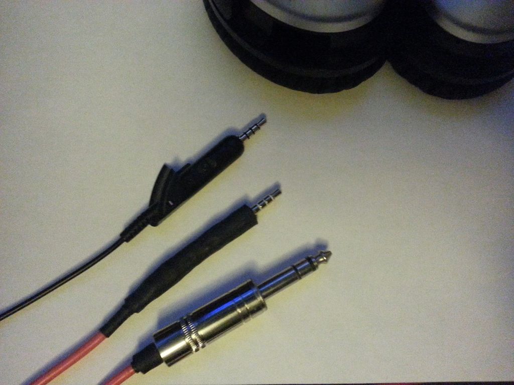

5 years ago on Introduction
5 years ago
My black athm50x and my white athm50 with the Bluetooth mod
