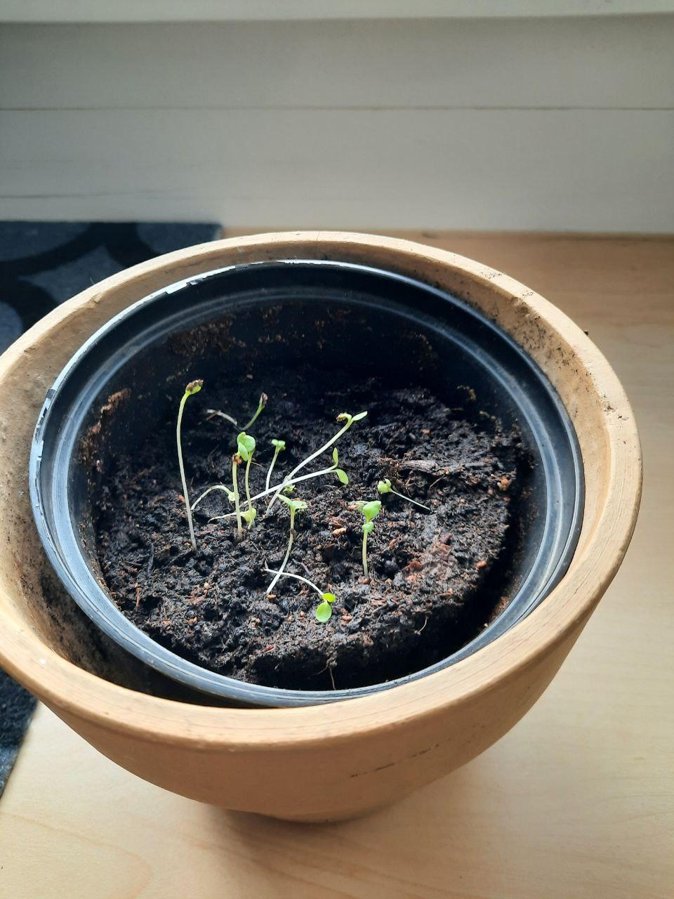

Step 5: The Plants Are Already Growing ...
Still small, but the plants are already growing and the bees are looking forward for visiting and harvesting them!
