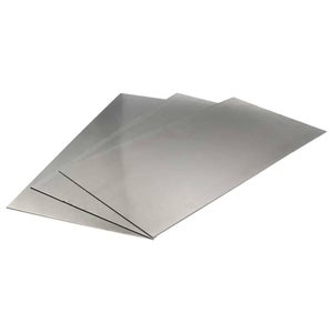

  1. Thick Aluminum Wire or Thin Metal sheet

If you are using a metal sheet, cut out a piece that measures 25 cm by 15 cm and bend it at a 90-degree angle. Trim off the corners at a 45-degree angle to create a V-shape.

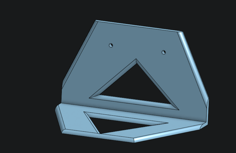

Step 8: For 3D Printing Nerds
Here is the 3D model for a floating bookshelf. You can print it and use it. Using PLA with a 0.8 mm nozzle would be ideal.
