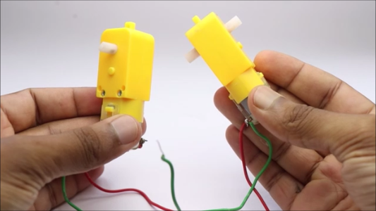

BO motor (60 rpm) with wheels

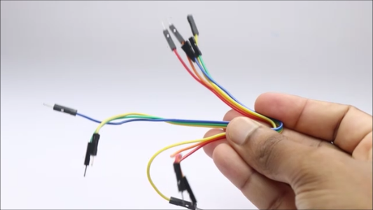

Jumper cables

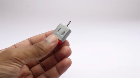

DC Motor

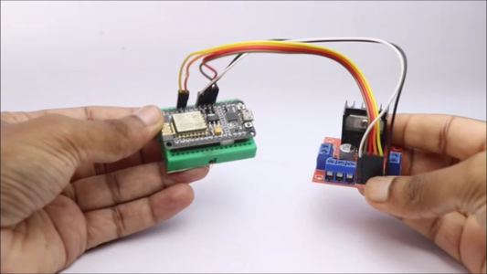

L298N Motor Driver to NodeMCU
IN1, IN2, IN3, IN4 of the motor driver are connected to the D1, D2, D3, and D4 pins of the NodeMCU. These pins control the direction of each motor.
The ENB and ENA pins on the motor driver control the speed of the motors. These are connected to PWM-enabled pins on the NodeMCU for speed control(Connected by default)
Connections for motors
The Left Motor is connected to the OUT1 and OUT2 terminals of the L298N motor driver.
The Right Motor is connected to the OUT3 and OUT4 terminals of the motor driver.
Power Connections
The 18650 batteries are connected to the motor driver’s power input (labeled 12V and GND) to provide the necessary power for the motors whereas the 5V output from the L298N motor driver is used to power the NodeMCU via the Vin pin on the NodeMCU board.

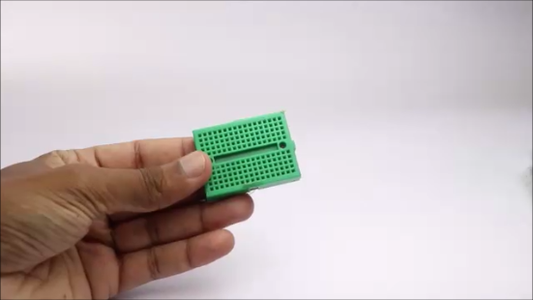

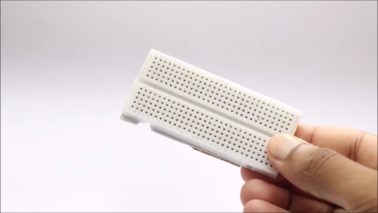

The GND pin of the NodeMCU, motor driver, and battery are all connected to create a common ground and for this, i used a small breadboard.
Instead of the breadboard, you can connect all the wires together, anyways it is your choice to do so.

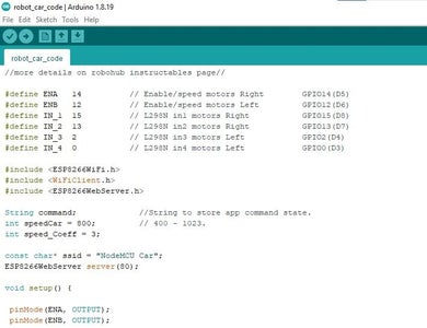

After you make the connections connect your nodemcu to computer and open arduino IDE.
Copy and paste the below code, Select the proper port and type of board from the menu and click on the upload button.

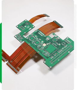

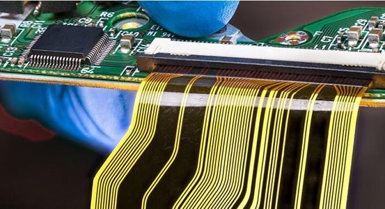

Check Here for Rigid-flex Pcbs with this your circuit becomes flexible! I have added the images to this step kindly check.
A revolutionary solution that combines the best of both rigid and flexible circuitry to elevate your electronic projects to new heights.
With their expertise in advanced manufacturing techniques, they offer a seamless integration of rigid and flexible components, ensuring enhanced reliability, durability, and space-saving benefits.

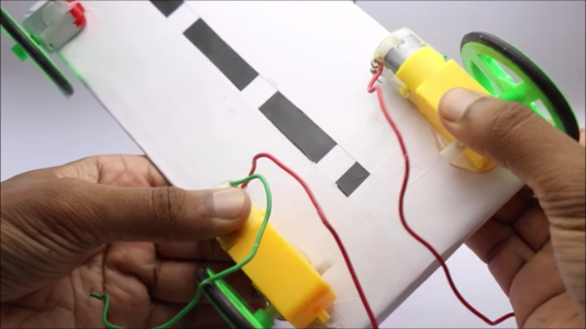

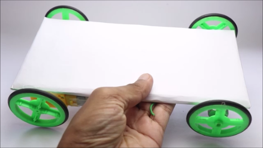

Step 2: Wheels and Body

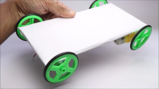

There is no specific rule on using the type of wheels, In my case i will be using these slim wheels with rubber grips.
Wheels of this type will make the car look great and also are light in weight and good to go on almost all basic surfaces, If you are willing to use them in rugged or extreme conditions choose another type of wheels.

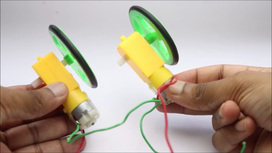

As I mentioned earlier I will be using rear wheel drive in this project and the front wheels are simply connected to a toy dc motor
The purpose of connecting front wheels to these motors is to ensure smooth movement which on the other hand is possible via bearings, So all thanks to those DC motors which save my resources.

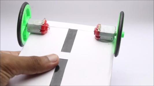

Apply hot glue on the edges of the cardboard and place the DC motor over it, Hold it for some time and allow it to dry completely.

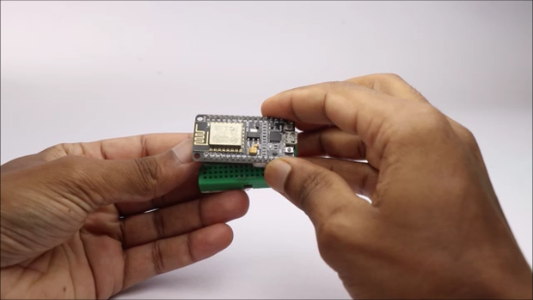

Step 3: Circuitry

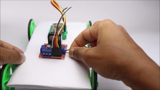

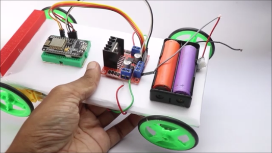

After you have followed the circuit explanation within minutes you can build the connection between components.
Start by connecting the nodemcu board directly to the breadboard first, Use jumper cables to establish connection between the electronics.
Double sided adhesives are recommended to keep the breadboard and motor driver secure in the cardboard base.
Connect the DC motor to the driver in the end because some cases the direction of rotation will be different so be aware of that.

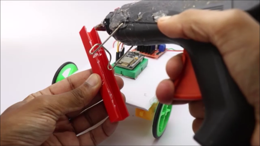

There are many ways to modify this base look, i simply used a piece of red stick and glued it to the front, You can also use LED strips here, The choice is yours.

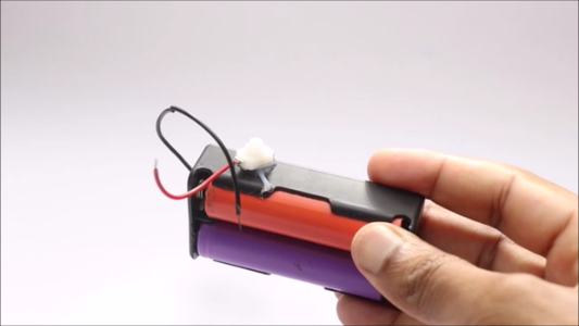

After these are ready add the battery pack, i used lithium-ion battery which comes with great power backup

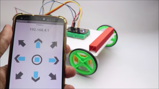

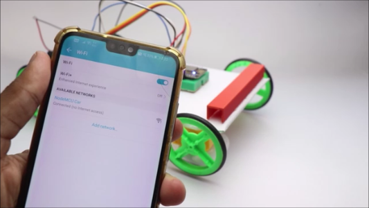

Well using this is fun, all you have to do is power on the battery via the switch and turn on wifi on your smartphone.
The board will automatically be connected to the network and all you have to do is open the app and allow a few seconds to connect, Get the free app here
You will see a message that says the connection is successful, After this you will have all the control of this car.
There are more than 9 directions in which you can run this car, Explore all the button and there is a speed control button and break button too that works pretty well for this car.
