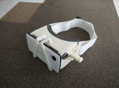

We 3d printed this open source VR headset from the site http://www.durovis.com/opendive.html.
Added some cushion and elastic strap for hands-free and comfortable viewing.
