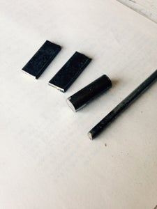

Step 1: Parts
I am making a basic hinge.
The parts are two pieces of 1/8 x 1/2 inch steel bar 1 1/4 inch long each, a piece of 3/8 inch steel rod 1 1/16 inch long, and about 1 5/16 inch of 3/16 inch steel rod.

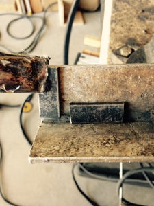

I used a piece of 1 1/2 x 1 1/2 inch aluminum angle to hold and position leaf pieces for welding to the 3/8 inch hinge body rod. The end of the leaf on the left in the photo is placed 3/16 inch, or half of the diameter of the 3/8 inch rod, above the bottom of the inner corner. The other leaf piece will act as a spacer for the welding setup. See the second photo.
I dropped the 3/8 inch rod into the corner of the aluminum angle and welded the first leaf to the body of the hinge. See the third photo. I clamped the welded leaf to the flat surface of the aluminum with a spring clamp. I welded the second leaf to the body of the hinge.
(There is a text box on the second photo, but it does not show. Click on the photo and you can access the text box.)

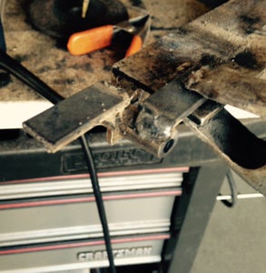

Step 4: Weld the Leaves on the Underside
For strength I turned the assembly over and welded the ends of the leaves to the body of the hinge. Grind the weld beads so they are flush with the face of the leaves on the underside.

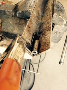

Step 5: Cut the Body in Half
The leaves are 1/2 inch wide each, but the body is 1 1/16 inch long. The extra 1/16 inch is for waste when the two halves of the hinge are cut apart with a cutting wheel on an angle head grinder. Try to cut squarely to the body so the hinge works smoothly. This is not always easy when "eyeballing" and cutting by hand. Make corrections with a grinder.

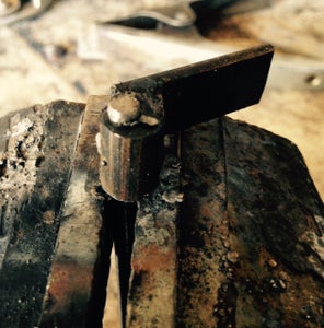

Step 6: Weld the Hinge Pin to Half of the Hinge
Allow about 1/8 inch of the hinge pin to extend beyond the bottom of the body. Weld it in place. Slip the other half of the hinge onto the hinge pin. Cut the hinge pin to length and round the top edge of the hinge pin.
