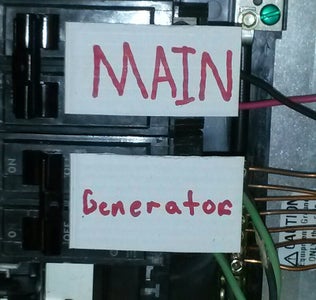

Step 5: Main Breaker
1. Always turn the Main Breaker off before turning on any backup power source.
