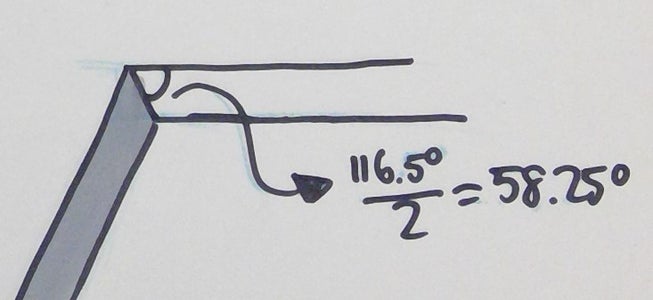

Step 2: Do Some Math.
A regular dodecahedron has 12 sides, which are each regular pentagons. The angle between these sides is 116.5 degrees. Regular pentagons have identical side lengths, and 108 degrees between each side. (Source: Wikipedia) The pentagons for my build were 3.5" per side, but you can make them whatever you like.
The one thing that's completely inflexible is what I call the critical angle, which I calculated out for y'all.
- Each edge on the dodecahedron is the intersection of two planes.

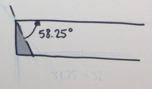

- Assuming that each plane contributes an even amount of material, you can divide the 116.5 degree dihedral angle by 2, which gives 58.25 degrees per side.
- Assuming that your bandsaw is set to cut square, the edge of each material is set to contribute 90 degrees.
- Taking the difference of 90 degrees and 58.25 degrees, you are left with 31.75 degrees.
The critical angle is ~32 degrees, which will be important in a few steps.

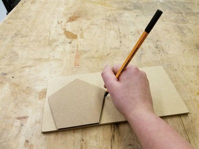

Step 3: Cut Out MDF Pieces.
The most important part of making a regular dodecahedron is making sure that all of the sides are identically sized, and the easiest way to do that is by making a template. I made a pentagon template by drawing a pentagon in Inkscape, and cutting it out of random scrap cardboard on the laser cutter. I also made a trapezoid template in the same way. (If you don't happen to have a laser cutter handy, you can spray adhesive to glue a paper template onto your MDF.)
Once you've transferred the patterns for 4 pentagons and 3 trapezoids of the appropriate size, take the 1/4" MDF to the bandsaw and free hand the shapes out of your material.
Step 4: Sand Down MDF Edges to Fit.
Recall the critical angle of ~32 degrees, and angle the table on your disk sander down by that much. Sand the correct sides down on each of your pieces of MDF by evenly applying pressure to the piece as the soft, soft MDF grinds away. Stop applying pressure when you can see the top edge of the MDF being sanded down by the wheel.
