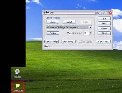

Step 2: Dorgem
You just have to download the app from the link and run it.
After it's installed open it up.
http://dorgem.sourceforge.net/ or
http://prdownloads.sourceforge.net/dorgem/dorgem210.exe direct download link

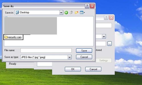

Step 3: Folder
Create a New Folder anywhere you want and name it as you wish.
I named mine security cam.

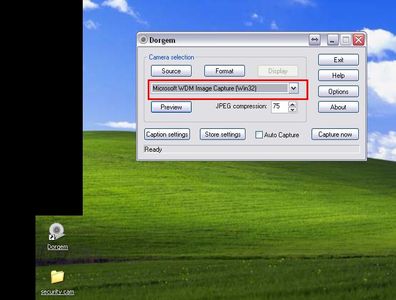

Step 4: Chose Your Camera
Select your webcam. Make sure it's connected properly.

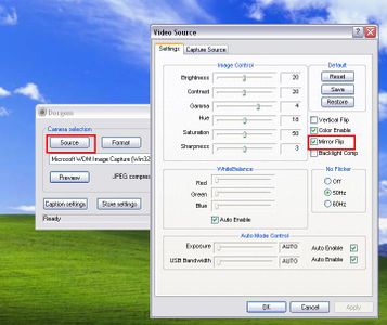

Step 5: Video Scource
If you want to change your camera setting such as Brightness,Contrast... Just click Source than Video Source window will open
Than I suggest you to mark " Mirror Flip"
This will make camera take real pictures not mirrored

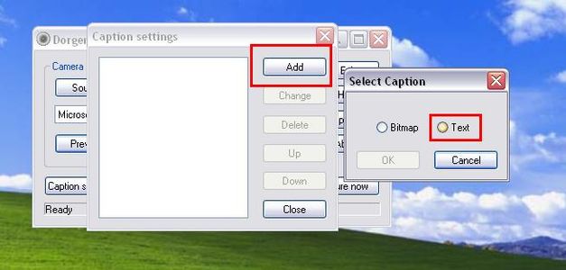

Step 6: Caption Settings
Click Caption Setting -> Add -> Text -> OK

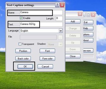

Than type any name you want
After done that
Type the box named Text:
I named mine Camera %G%g
This is the name that pictures taken from cam are going to have it.
%G%g is to save it in form of data.
After done that click OK

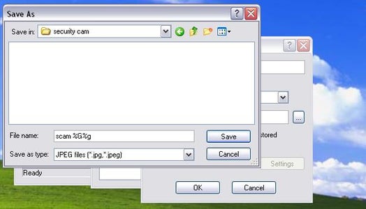

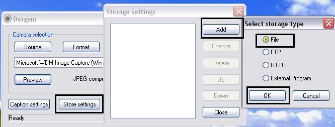

Step 7: Store Setting
Click Store setting -> Add -> mark File -> OK

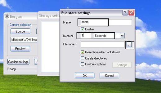

Than in File Store Settings type the box named Name:
I called "scam"
After you done that click "Interval"
And this will tell your cam how often it will take pictures after a motion is detected.
In the File name box choose the folder created before in step 3.
Than type File name:
Again scam %G%g and than click save

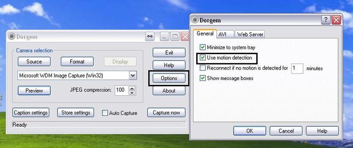

Step 8: Options
Click options than mark " use motion detection"

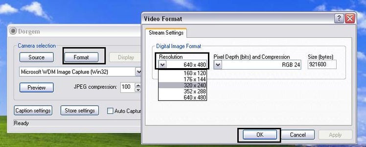

Step 9: Video Format
In this step you can choose your webcam resolution
Higher resolution,better picture quality,and more kbytes
To do that click Format -> Resolution

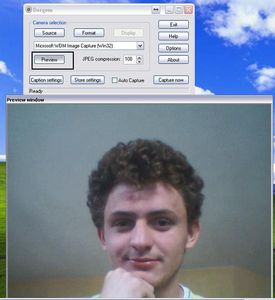

Step 10: Preview Window
If you want to see what cam sees click " Preview"

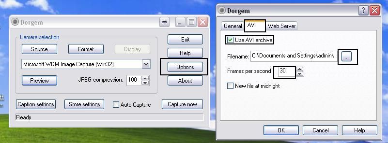

Step 11: AVI
If you want to record a video when motion is detected
Click Options-> AVI -> Use AVI Archive
Than select folder and choose Frames Per Second (fps)
Fps are how many times camera is going to take a picture in each second
I chosen 30fps to have more detailed video

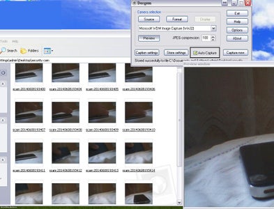

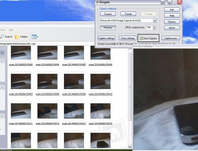

Step 12: Final Step; Auto Capture
Position Webcam in the object or anything you want to protect or anything else
Than mark Auto Capture
Right now your Motion Detection Camera is activated
Hope you enjoyed that...
Step 13: Result
Some Auto Captured pictures
