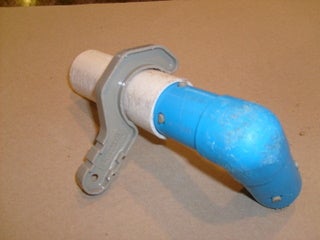

This is the original tool. I had located an original by the time I made this Instructable, so I am able to show you how the original wrench looks and works. At the time I made the tool, I had to make the tool from memory (which wasn't very difficult in this case).
This toy has a variety of colored connector tubes and white tubes of various length.
This blue connector 'locks' into the white tube. The gray knobs in the blue connector stick out into holes in the white tube. The gray wrench has two little nubs that stick into the holes and push the gray knobs in so that the white tube can be removed. Without one of the gray wrenches the lock fit is very snug and hard to unlock or manipulate because the gray knobs are separated 180 degrees on opposite sides of the tubes.
My goal is to make a work-a-like for the gray wrench. The cosmetics are not important.

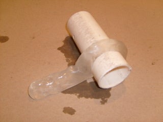

Step 4: Form the Tool
Take the blob of clear plastics (careful, it's hot!) and form it into a replacement tool.
Reinforce the areas that might have extra strain on them with extra plastic.
Since the plastic is reusable, don't worry about using too much.
Once it's in position set it aside carefully and don't touch it.
Step 5: Let Cool, Test Fit, and Use!
Let it cool thoroughly (if you try to use the tool too soon, it will lose its shape).
Compare to original tool if you have it, try a test fit, and use!
My handmade wrench is not terribly attractive, but works well and required just a small portion of the friendly plastic.
