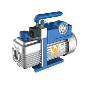

vacuum pump(The vacuum level needs to reach at least 0.1 Pa.)

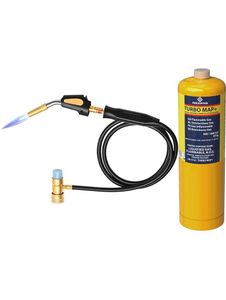

handheld gas torch

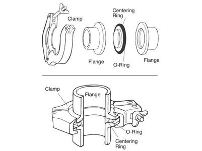

There are many different standards for vacuum connection. In this project, I chose KF(Klein Flange)-standard connectors, which offer a relatively inexpensive yet sufficiently reliable option. Another advantage of KF fittings is that they can be easily assembled by hand without the need for any tools.
Overall, our vacuum system is a simple three-way pipeline connecting the vacuum pump, the gas cylinder, and the glass tube that needs to be sealed. Several valves and pressure gauges are also installed along the system.

  2. Keep the valve at the gas cylinder closed, and open the valve at the vacuum pump. The vacuum pump will start evacuating air from the system.
  3. After some time, you can observe from the pressure gauge that the air has been fully evacuated.

To seal the glass, a strong flame must be used to heat the glass to above 800°C, at which point the glass will begin to soften. By pulling and squeezing it — feel somewhat like modeling clay — the glass can be sealed.
After sealing, it is important to perform annealing at the sealed joint. The temperature should not be allowed to drop too rapidly, in order to prevent internal stresses from causing the glass to crack.

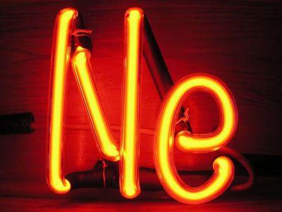

Step 5: Appreciate the Beauty of Noble Gases Glowing
I created a variety of gas-filled glass tubes, including helium, neon, argon, krypton, xenon, nitrogen, carbon dioxide, hydrogen, oxygen, and air. Under high-voltage excitation, each gas displayed its own distinct glow.I named this project Lumora — a combination of "luminous" and "aurora." Since many friends were interested in this gadget, I also launched a crowdfunding campaign on Kickstarter. To preserve them properly, I even had a custom box made. This has been my favorite project of the year.
