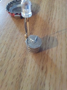

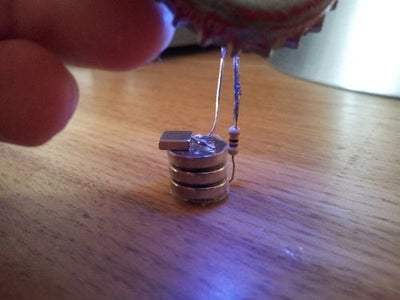

Step 4: Electronics
Tape the three button cells positive to negative.
Solder the resistor to one of the legs, doesn't matter which. The longer leg is the positive and the shorter one is the negative in case you needed to know.
Bend the legs at right angles so the batteries can just slide in.

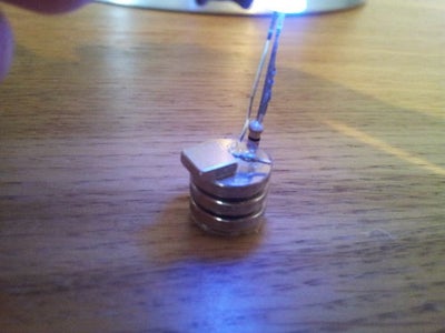

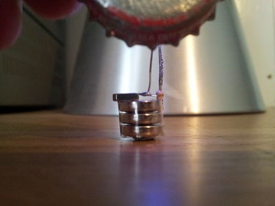

Use one magnet to secure the resistor leg bent into a square to the bottom of the batteries and also secure the whole lot to the bottle cap.
Now when you want the LED on use the magnet to push the other leg of the LED to the other side of the batteries.
Optional:
To get a stronger hold on the bottle cap you can use a mixture of heat, rubbing and acetone to remove the plastic from inside the bottle cap.
