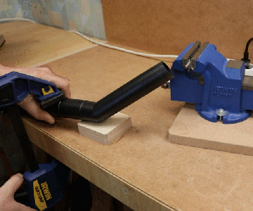

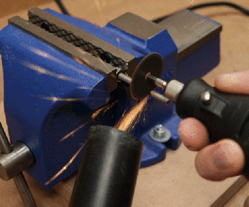

The main problem arises when you need to cut bolts, rods, and similar objects with the rotary tool. You probably realized that it can be a hassle to do it perfectly. And if you want to do it in a dust-free way clamping and adjusting things can be just a little bit frustrating.
If your experience is similar, then this jig for a rotary tool will make your life much easier. You clamp it to your workbench and do fully controlled cuts in a dust-free way. But what really sets it apart is those inserts for unlimited customizability. You can do some crazy cuts (two last images) that you never could do while handheld.

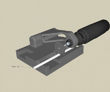

Step 2: Inspired by Fully 3D Printed Station
The idea to make it came from this fully 3D printed mini-cutting station. It looked really nice, but I instantly spotted some limits with it. You see Dremel’s metal cutting discs are pretty small in the first place and they will get smaller with use as they are, well abrasive.
This means that on this 3D printed station you can cut only smaller and shorter pieces as the workpiece will interfere with the handle. And keep in mind that this is not a design flaw of the station it is just a general limitation of a tool itself.
Step 3: 3D Printing All Parts?
And I don’t know if you ever cut a stainless-steel rod because it gets so hot that you’ll end up with a melted plastic base. Not only this but rough time and money estimates show that 3D printing all the parts of my design is just not worth it here.

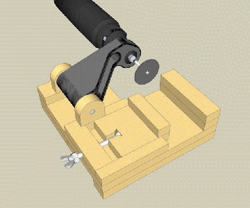

Step 5: Integrated Vice
The heart of this project is the integrated clamping system for all kinds of inserts.
Before doing more cuts make sure that the sliding part and surrounding ones have smooth surfaces by sanding them a little bit with ~400grit sandpaper.
Next, we need to cut a shape of a flush M6 bolt into the sliding part. Then make a 6mm hole that goes all the way through the piece and widen one side of it to 11mm for an M6 locking nut. Roughen the nut sides and glue it in with epoxy.
Later I additionally glued a washer to the sliding part. Epoxy will slightly soak into the plywood and together with a washer will give a tougher surface as all the clamping force goes to this spot.
The sliding part needs to go forward and backward just a little bit to clamp the same width inserts. This means that you won’t need to rotate it a lot. And as we are using a locking nut, vibrations won’t loosen the clamp, as they can do on a regular vice.
Step 6: More Gluing
So making the clamping system was the hardest part. Next, more drilling, shaping, and gluing. One thing to note here - don't forget that the right side of the handle holding part will not be glued to the base. Same with the top vice covering part.
I like to reinforce parts that will be affected by clamping forces with screws. This includes the lip of the inside sliding part, the front fence, and the back part (the part which has glued nut).

Step 9: Dust Collector
The second 3D printed part will be the dust collector. It is a 2-part print, that later we will need to glue with epoxy.
I suggest gluing a couple of small sheets of aluminum tape just to protect the plastic where all the hot sparks will fly.
I have a very specific and annoying shop-vac end hose and it is very rare that you will have the same one, so I will provide a universal solution for a 35mm end hose (last picture).
I also suggest cutting some metal mesh and gluing it on top of the dust collector. It will prevent very hot cutoff pieces to be sucked in and possibly damaging the hose, vacuum itself, or even ignite like wood sawdust. I never ever had any problems with shop-vac sucking all the sparks as those cool off inside the hose until they reach the inside container. But it can depend on the tools and the setup, so just be aware that hot sparks and wood sawdust combination are a bad idea in general.

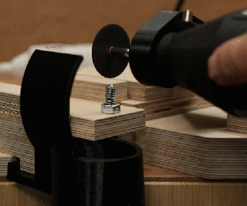

Step 11: The Inserts
To make inserts we need to cut some blocks of 40mm width and length depends on the type.
For the rod cutting insert, we just can make a groove into the piece with a router equipped with a V grooving bit.
For the clamping top piece, we just need to cut off a small part of a previous insert and trim width to something like 30mm instead of 40mm.
For bolt cutting - 40x100mm base and 20x20x2mm aluminum L profiles with drilled 3,4,5 and 6,8mm holes. Aluminum is great here as it also will absorb the heat from the bolt.

Step 13: How It Works
So with the upgrade, it is way better. Now we easily clamp the right side and for the left, we either clamp the base or the cutting piece, depending on the insert type.
And they are the key here. Some are more universal like I showed before (rod and bolt cutting). You can even clamp the bolt cutting insert at an angle and do some deburring work. And others can be customized just for a specific result like doing a complex cut on a vertically placed bolt.
